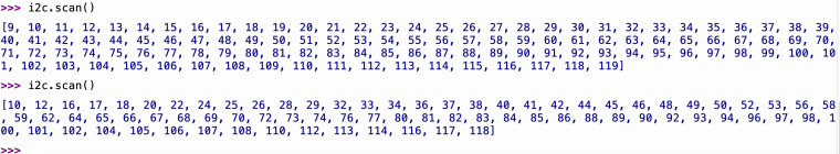

]]></description><link>https://community.m5stack.com/post/20103</link><guid isPermaLink="true">https://community.m5stack.com/post/20103</guid><dc:creator><![CDATA[ajb2k3]]></dc:creator><pubDate>Thu, 16 Feb 2023 17:14:06 GMT</pubDate></item><item><title><![CDATA[Reply to Micropython M5Stamp Stamp I&#x2F;O Help please? on Thu, 16 Feb 2023 06:23:52 GMT]]></title><description><![CDATA[<p dir="auto"><a class="plugin-mentions-user plugin-mentions-a" href="/user/teastain" aria-label="Profile: teastain">@<bdi>teastain</bdi></a> <a class="plugin-mentions-user plugin-mentions-a" href="/user/felmue" aria-label="Profile: felmue">@<bdi>felmue</bdi></a> I've read, reread and experimented in micropython and still get a problem trying to control it.<br />
Mind you I have a cold so my brain isn't at its best but every time I trying to i2c.write() it causes a Error19: ENOMEM meaning I'm doing something wrong.</p>
<p dir="auto">Something about access the registers is not working for me.</p>

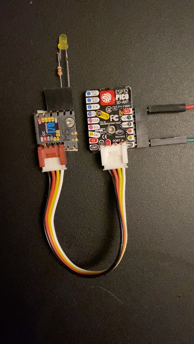

Adam, I nearly went mad getting this to work! Part of the problem was wrapping my brain around how it worked. It is a silly invention of little use, I say!<br />
I found a weakness in the library that prevented individual pin functions, like pin 1 input, pin 2 RGB, pin 3 output.<br />
Our friend felix edited the library header and did a pull request and now they are all individually selectable. This image is actually a short video, but I don't think I can upload it here. Imagine if you will, the LED blink-ing...<br />
However the examples were NOT updated and they still say "AllPinMode", so this is confusing.<br />
I realize this is C, but it might be illustrative for translation to UIflow?<br />
Terry</p>
