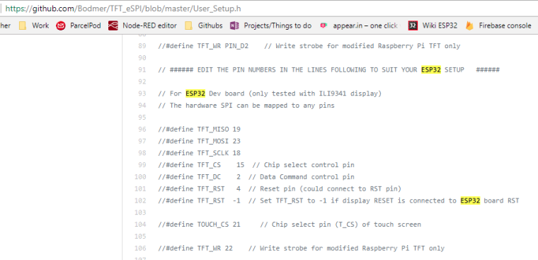

<p dir="auto">I'm guessing that there isn't any more modifications that you had to make to get it working?</p>
]]></description><link>https://community.m5stack.com/post/191</link><guid isPermaLink="true">https://community.m5stack.com/post/191</guid><dc:creator><![CDATA[skelstar]]></dc:creator><pubDate>Mon, 15 Jan 2018 18:47:12 GMT</pubDate></item><item><title><![CDATA[Reply to Suggestions for future releases. on Mon, 15 Jan 2018 17:58:40 GMT]]></title><description><![CDATA[<p dir="auto">Hey <a class="plugin-mentions-user plugin-mentions-a" href="/user/tonywestonuk" aria-label="Profile: tonywestonuk">@<bdi>tonywestonuk</bdi></a>. I tried using the TFT_eSPI library that you mentioned (I'm having issues with nRf24L01 and LCD working together). When you specified the pins for CS/CE did you use the "D8" node-mcu type pin names or just "27"? If so I wouldn't mind knowing what values (I know which GPIO pins I should be using).</p>
<p dir="auto">Cheers!</p>
]]></description><link>https://community.m5stack.com/post/190</link><guid isPermaLink="true">https://community.m5stack.com/post/190</guid><dc:creator><![CDATA[skelstar]]></dc:creator><pubDate>Mon, 15 Jan 2018 17:58:40 GMT</pubDate></item><item><title><![CDATA[Reply to Suggestions for future releases. on Mon, 23 Oct 2017 17:35:05 GMT]]></title><description><![CDATA[<p dir="auto">All very cool, but if its real it will be better if main core and bottom will have 4 M3 screws instead of 2, becouse main and bottom cores not fully close together.</p>
