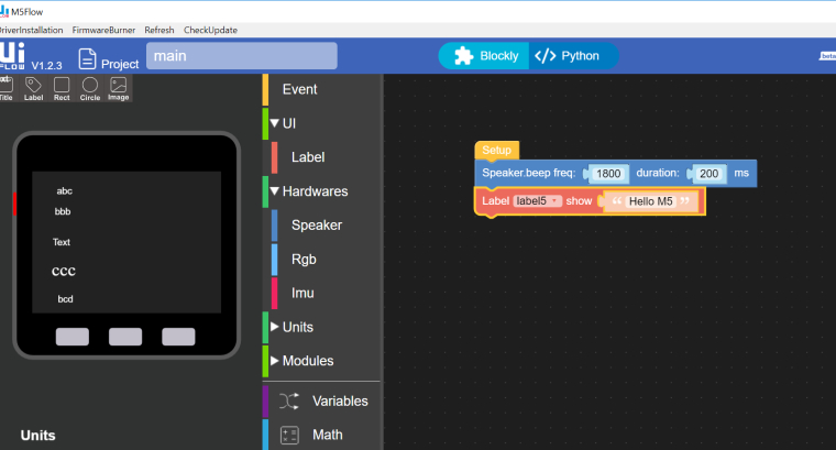

<?xml version="1.0" encoding="UTF-8"?><rss xmlns:dc="http://purl.org/dc/elements/1.1/" xmlns:content="http://purl.org/rss/1.0/modules/content/" xmlns:atom="http://www.w3.org/2005/Atom" version="2.0"><channel><title><![CDATA[[NEW] UiFlow-Desktop V1.2.3 , not possible to graphically select individual text LABELS to edit them]]></title><description><![CDATA[<p dir="auto">This bug on  UiFlow-Desktop V1.2.3  (Windows 10 64bit via USB - target M5Go) appears from the very first day i used it more than a week ago. Very often if you have added multiple text labels to the virtual M5 screen on the UiFlow-Desktop you are not able to re-select them individually to modify its atributes i.e. the label number,  text content nor font type. Let's say i have five labels on the virtual screen then on anyone i click it just show me the very same label information (not sure which one, probably just the last one i added just before the bug showed up).  This is extremely annoying as the only workaround is to define the proper text content programatically BUT for example the font size cannot be set programatically so the application just looks ugly and the default font is too small. Please fix this! (NOTE: i cannot say if the bug is also present on the UI-Flow browser version because the connection via internet is extremely unreliable here in China and it almost never connect).</p>

]]></description><link>https://community.m5stack.com/post/4554</link><guid isPermaLink="true">https://community.m5stack.com/post/4554</guid><dc:creator><![CDATA[lukasmaximus]]></dc:creator><pubDate>Fri, 07 Jun 2019 17:00:05 GMT</pubDate></item><item><title><![CDATA[Reply to [NEW] UiFlow-Desktop V1.2.3 , not possible to graphically select individual text LABELS to edit them on Fri, 07 Jun 2019 12:10:53 GMT]]></title><description><![CDATA[<p dir="auto">I have the same issue and I'm using the Internet version. In <a class="plugin-mentions-user plugin-mentions-a" href="/user/liushasha" aria-label="Profile: liushasha">@<bdi>liushasha</bdi></a>  example, you now have 5 labels in your project. If you select the labels to edit them, like I want to rename "label5" to "welcomeMessageLabel", I can't. If you click on it to change the properties it will show the settings for the first label added. The only time you can edit them is when you first drop them in, after that you can't anymore.</p>
]]></description><link>https://community.m5stack.com/post/4553</link><guid isPermaLink="true">https://community.m5stack.com/post/4553</guid><dc:creator><![CDATA[J_Gat]]></dc:creator><pubDate>Fri, 07 Jun 2019 12:10:53 GMT</pubDate></item><item><title><![CDATA[Reply to [NEW] UiFlow-Desktop V1.2.3 , not possible to graphically select individual text LABELS to edit them on Mon, 20 May 2019 07:01:07 GMT]]></title><description><![CDATA[<p dir="auto">Hello, I got the same setup environment like yours, I don't see any problem as you said,would you expain more in details .<img src="/assets/uploads/files/1558335628108-1558335515-1-resized.jpg" alt="0_1558335626569_1558335515(1).jpg" class=" img-fluid img-markdown" /> <img src="/assets/uploads/files/1558335629983-wechat-image_20190520145901.jpg" alt="0_1558335629209_WeChat Image_20190520145901.jpg" class=" img-fluid img-markdown" /></p>
]]></description><link>https://community.m5stack.com/post/4340</link><guid isPermaLink="true">https://community.m5stack.com/post/4340</guid><dc:creator><![CDATA[liushasha]]></dc:creator><pubDate>Mon, 20 May 2019 07:01:07 GMT</pubDate></item><item><title><![CDATA[Reply to [NEW] UiFlow-Desktop V1.2.3 , not possible to graphically select individual text LABELS to edit them on Sat, 18 May 2019 00:59:44 GMT]]></title><description><![CDATA[<p dir="auto">Yep, I’ve experienced the same issue before. Seems to be a bug on the uiFlow side. Hoping it can be fixed soon.</p>
