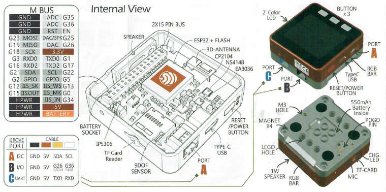

I am little confused by the work and description of ckuehnel and would like to ask the following questions.</p>
<p dir="auto">Do I understand it correct:</p>
<ul>
<li>
<p dir="auto">It works fine, if all 6 sensors are connected "in parallel" to the GROVE-PORT B (GND=black, 5V=red, G26=yellow) plus the 4,7kohm resistor?</p>
</li>
<li>
<p dir="auto">There is NO need to access any I/O-pins via the M-bus-connector?</p>
</li>
</ul>
<p dir="auto"><img src="/assets/uploads/files/1559840522331-grove-connector-fire-s-resized.jpg" alt="0_1559840519810_GROVE-Connector FIRE s.jpg" class=" img-fluid img-markdown" /></p>
