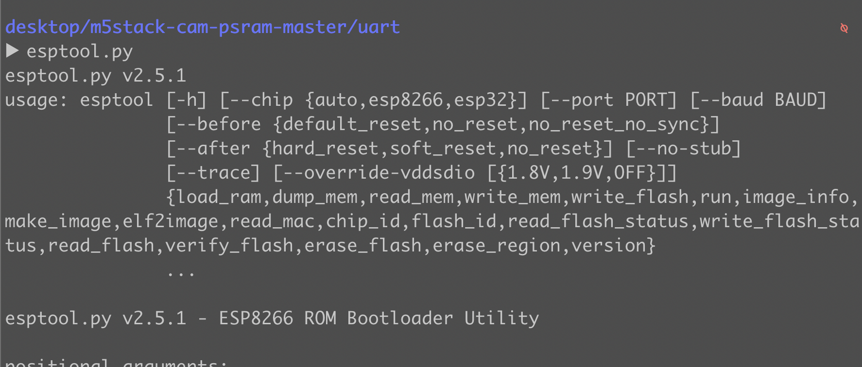

<p dir="auto">2, To check if have 'esptool' installed:  type command <strong><a href="http://esptool.py" target="_blank" rel="noopener noreferrer nofollow ugc">esptool.py</a></strong> , in 'terminal'. If a display showed this, means it is installed.<img src="/assets/uploads/files/1558597921640-screen-shot-2019-05-23-at-3.24.02-pm-resized.png" alt="0_1558597890128_Screen Shot 2019-05-23 at 3.24.02 PM.png" class=" img-fluid img-markdown" /></p>

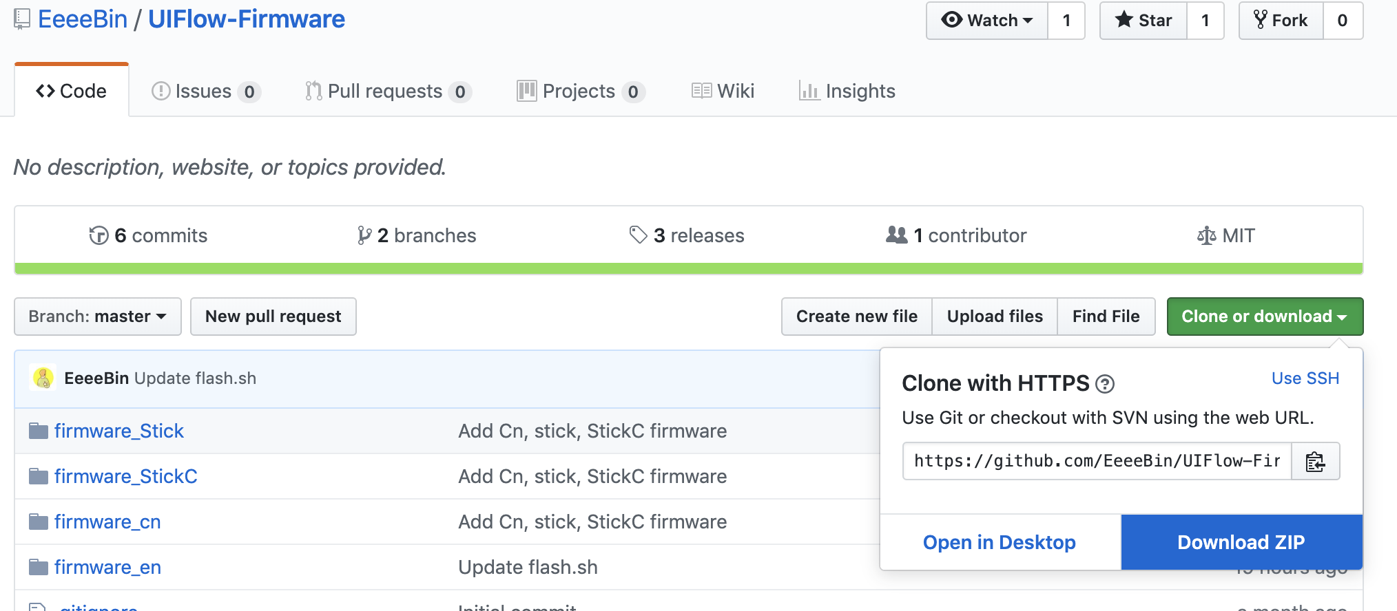

<p dir="auto">3, Download uiflow-firmware: <a href="https://github.com/EeeeBin/UIFlow-Firmware" target="_blank" rel="noopener noreferrer nofollow ugc">https://github.com/EeeeBin/UIFlow-Firmware</a> , unzip.<img src="/assets/uploads/files/1558598081725-screen-shot-2019-05-23-at-3.53.50-pm-resized.png" alt="0_1558598050306_Screen Shot 2019-05-23 at 3.53.50 PM.png" class=" img-fluid img-markdown" /></p>

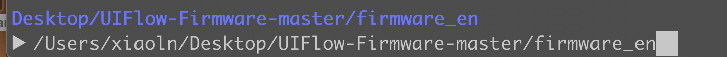

<p dir="auto">4, At 'terminal' find directory locate directory to '.../UIFlow-Firmware-master/firmware_en'<img src="/assets/uploads/files/1558598414601-screen-shot-2019-05-23-at-3.59.17-pm-resized.png" alt="0_1558598383463_Screen Shot 2019-05-23 at 3.59.17 PM.png" class=" img-fluid img-markdown" /></p>
