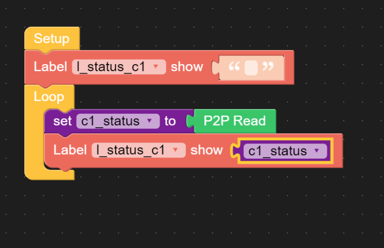

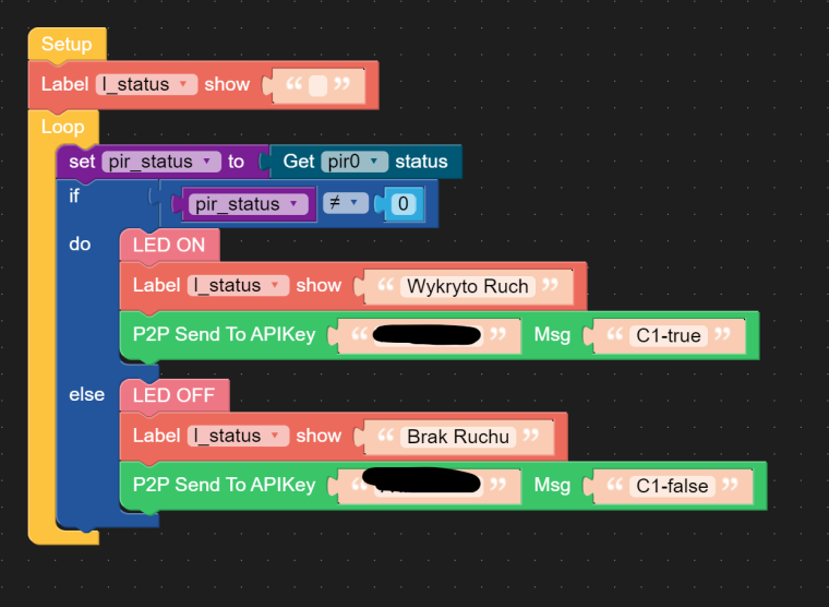

<img src="/assets/uploads/files/1560284519733-02868fb4-2fcb-4d7b-af09-acbe71b61716-image-resized.png" alt="0_1560284519213_02868fb4-2fcb-4d7b-af09-acbe71b61716-image.png" class=" img-fluid img-markdown" /></p>
<p dir="auto">this is my Stick-C with PIR<br />
and at the end Core with:<br />
<img src="/assets/uploads/files/1560284479688-1f60cfb1-ded6-41f7-b360-d9a8f610ceca-image-resized.png" alt="0_1560284478686_1f60cfb1-ded6-41f7-b360-d9a8f610ceca-image.png" class=" img-fluid img-markdown" /></p>
