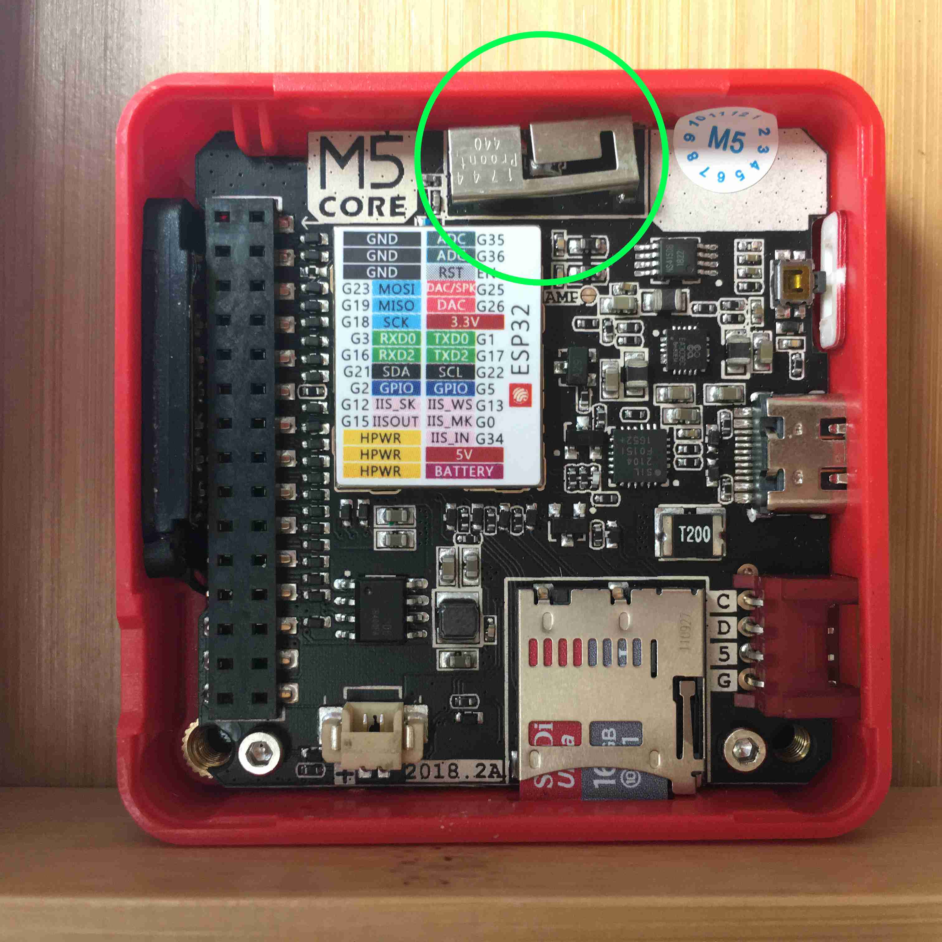

<?xml version="1.0" encoding="UTF-8"?><rss xmlns:dc="http://purl.org/dc/elements/1.1/" xmlns:content="http://purl.org/rss/1.0/modules/content/" xmlns:atom="http://www.w3.org/2005/Atom" version="2.0"><channel><title><![CDATA[WIFI-Problem because of bended 3D-Antenna?]]></title><description><![CDATA[<p dir="auto">My brand-new M5Fire has a very low WIFI-sensitivity: The WIFI-router is located one floor higher than my office. In the office my iphone and Laptop is able to connect to WIFI, the M5Fire does NOT connect. If the M5Fire is in direct sight to the router, it does connect!<br />
I opened the M5Fire and discovered, that the 3D-Antenna seems to be bended - see picture (as compared to pictures of the open M5Fire on <a href="http://m5stack.com" target="_blank" rel="noopener noreferrer nofollow ugc">m5stack.com</a>).<br />
Questions:<br />
a) Can I expect a similar WIFI-sensitivity of the M5Fire as compared to i.e. an iphone?<br />
b) Does a bended 3D-Antenna really reduce the WIFI-sensitivity significantly?<br />
c) Would you recommend to try to fix the bended 3D-Antenna or return the M5Fire (to Amazon)?</p>

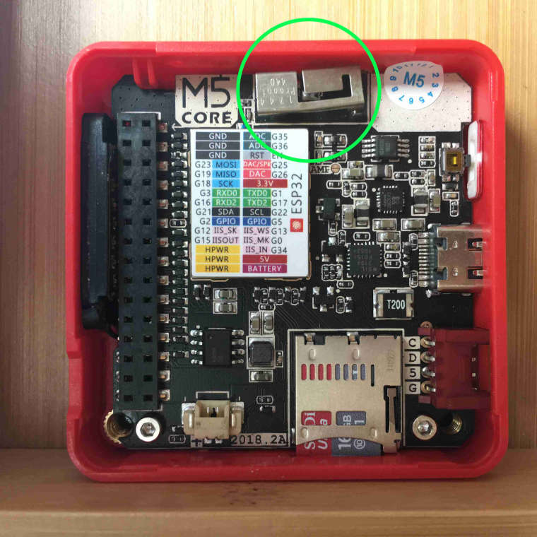

I tried to fix the 3D-antenna by bending it back to its regular form.<br />
Reault: Compared to before, the WIFI-sensitivity is unchanged very low!</p>
