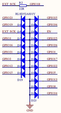

Just make sure, that the current from the 5V-line thru the diodes does not exceed the rated continious value.<br />
As I want to connect several DS18B20 temperature sensors via Grove B port, I will have to connect a 4,7 kohm resistor between 5V-line and data-line (which is connected to GPIO 26 of the ESP32).<br />
Although I didn't find the continious current rating of the DS18B20, I think it will be ok: I = (5V-3,3V)/4700 ohm = 0,36 mA. P-Diode = 3,3V*0,36mA=1,2mW.!</p>
<p dir="auto"><strong>ADDENDUM/NOTE: the attached schematic is an extract of the M5STACK schematic and my comments are therefore valid for the M5STACK only. Unfortunately I have not found the Schematic of the M5STICKC and therefore I don't know if there are clamping-Diodes build in.</strong></p>
<p dir="auto"><img src="/assets/uploads/files/1560408588966-m5stack-3.3v-clamping-diodes.jpg" alt="0_1560408590015_M5Stack-3.3V-Clamping-Diodes.jpg" class=" img-fluid img-markdown" /></p>
]]></description><link>https://community.m5stack.com/post/4617</link><guid isPermaLink="true">https://community.m5stack.com/post/4617</guid><dc:creator><![CDATA[grelm]]></dc:creator><pubDate>Thu, 13 Jun 2019 06:49:52 GMT</pubDate></item><item><title><![CDATA[Reply to 5V input concern on M5StickC on Thu, 13 Jun 2019 04:31:17 GMT]]></title><description><![CDATA[<p dir="auto"><a class="plugin-mentions-user plugin-mentions-a" href="/user/wikistik" aria-label="Profile: wikistik">@<bdi>wikistik</bdi></a> It is because the grove standard uses 5v power lines but each unit contains a 5v to 3v3 step down power supply where needed.</p>
