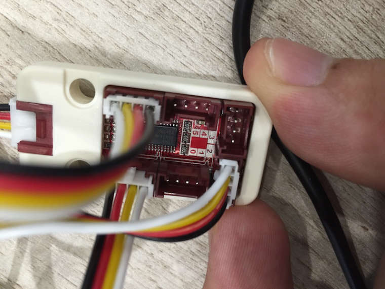

<img src="/assets/uploads/files/1566978740639-screen-shot-2019-08-28-at-15.18.21.png" alt="0_1566978740475_Screen Shot 2019-08-28 at 15.18.21.png" class=" img-fluid img-markdown" /><br />
Then you must select the port of the Pahub you wish to connect to. The port numbers are labelled on the pcb if you look closely.<br />
<img src="/assets/uploads/files/1566978833316-wechatimg227-copy-resized.jpeg" alt="0_1566978833032_WechatIMG227 copy.jpeg" class=" img-fluid img-markdown" /><br />
