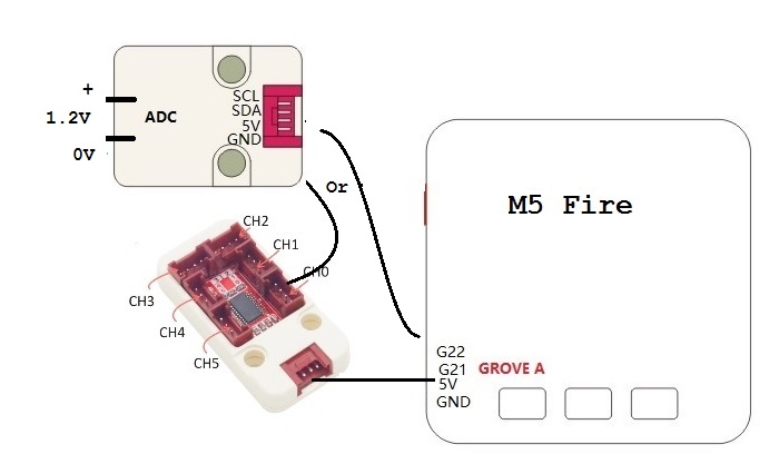

<p dir="auto">Although early days, i've just ploughed into a possible noob problem! I'm needing to connect ADC (unit) via PaHub (unit) to M5 Fire (port A). All good except i'm getting way out comparison readings.. As follows</p>
<p dir="auto">--&gt; Using the ADC via PaHub to Fire (portA ) vs running ADC directly via Fire (portA) no PaHub.<br />
<img src="/assets/uploads/files/1561799994413-m5muxadc00.jpg" alt="0_1561799990671_M5MuxADC00.jpg" class=" img-fluid img-markdown" /></p>
<p dir="auto">So using ADC via PaHub reading ~ 2610 (Int), using ADC to Port A directly ~ 3120 (int), 1.2 VDC battery connected to ADC.</p>
<p dir="auto">I'm aware that I2c pullUp resisters exist on HUB &amp; ADC,  in parallel (total ~ &gt; 3 kOhm), which should be ok.</p>
<p dir="auto">Any thoughts would be appreciated..</p>
<p dir="auto">Cheers</p>

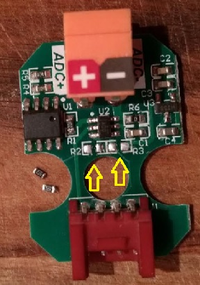

Just reached my knowledge of i2c and yeh found that the pullups have bee put on the hubs i2c lines as well as the line to the M5Stack port a.<br />
nice but of bug fixing.<br />
Just don't forget to put them back if you want to connect the ADC directly to the M5stack in future.</p>

<p dir="auto">Remove 4.7K Ohm pull up's from i2c lines!, un-soldered from ADC (Mux resistors were too small/difficult to get to) would have liked to remove resistors from Mux as possible issue will also effect other connected units.</p>
