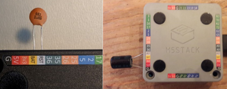

<p dir="auto">You can also use RST and BAT since it's easier (IMO).  <a href="http://forum.m5stack.com/topic/113/an-even-simpler-fix-when-upload-fails" target="_blank" rel="noopener noreferrer nofollow ugc">http://forum.m5stack.com/topic/113/an-even-simpler-fix-when-upload-fails</a></p>
<p dir="auto">I heard the new M5's don't need the cap but I'm waiting for a new one to arrive to confirm.</p>

Hi bflo, this situation can be found on a number of devices...  On M5Stack It can be be addressed as follows:</p>
<p dir="auto"><strong>1) Immediate fix:</strong><br />
When IDE tries to connecct to M5 - when it shows this on-screen - "Connecting .... ____ ..... ____ ......." , you need to press the red reset button. Press it twice - first time short, then hold 5 seconds. Then press twice quickly  - click, click. It probably start to beep - just repeat the above..  or even just keep holding the button in....  You should find after some combination of the above it will connect. You may have to try a second time. After doing it a few times you should "get the knack" and be able to reliably get it to load first time, each time.</p>
<p dir="auto">This should work but its easier to do one of the following....</p>
<p dir="auto"><strong>2) Long term fix:</strong><br />
Connect a capacitor between the RST and GND ports.  Can be standard through hole cap.  <a class="plugin-mentions-user plugin-mentions-a" href="/user/mikemoy" aria-label="Profile: mikemoy">@<bdi>mikemoy</bdi></a> recommended up to 10 uF max, although I've been using 22 uF. If your cap is polarised be sure to connect negative to the GND port.  <a class="plugin-mentions-user plugin-mentions-a" href="/user/scotts" aria-label="Profile: scotts">@<bdi>scotts</bdi></a> recently suggested using a non-polarised ceramic cap such as the relatively common 0.1 uF.... eg. one with the number 104 printed on it. (the pic below shows 0.068 uF in use).</p>
<p dir="auto">You could also get a proto module board and solder the cap to the pads marked on the proto board as GND and EN (=RST). I will probably try this with 0.1 uF cap.</p>
<p dir="auto">Users with an earlier model can also use an SMT cap and solder it to the circuit board - but that doesn't apply to your model with the 4 Mb PS-RAM and MPU9250.</p>
<p dir="auto"><img src="/assets/uploads/files/1519579559988-m5stack-capfix-resized.jpg" alt="0_1519579557495_M5Stack-CapFix.jpg" class=" img-fluid img-markdown" /></p>
