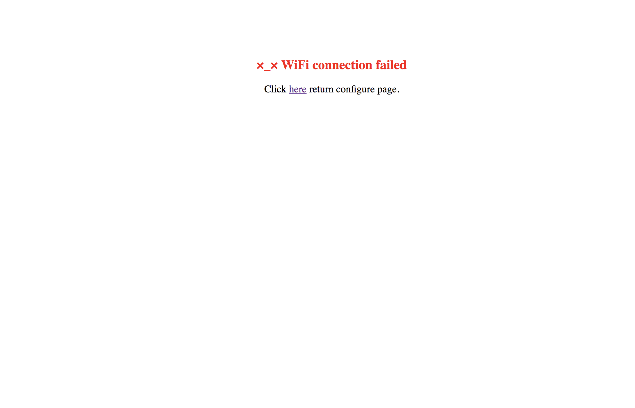

<?xml version="1.0" encoding="UTF-8"?><rss xmlns:dc="http://purl.org/dc/elements/1.1/" xmlns:content="http://purl.org/rss/1.0/modules/content/" xmlns:atom="http://www.w3.org/2005/Atom" version="2.0"><channel><title><![CDATA[M5Stick C UI Flow WIFI Connection Problem.]]></title><description><![CDATA[<p dir="auto">Hi There,</p>
<p dir="auto">I've been looking for a solution to connecting stick c to wifi.</p>
<p dir="auto">how did I flow;</p>
<p dir="auto">1: install Silicon Labs VCP Driver<br />
2: M5 burner ( ui flow 1.3.5-beta)<br />
3: I entered the interface ( 192.168.4.1)<br />
4: I entered the wifi and password</p>
<p dir="auto"><img src="/assets/uploads/files/1565091805765-screen-shot-2019-08-06-at-14.25.14-resized.png" alt="0_1565091802572_Screen Shot 2019-08-06 at 14.25.14.png" class=" img-fluid img-markdown" /></p>
<p dir="auto">any ideas?</p>
<p dir="auto">thanks.</p>
]]></description><link>https://community.m5stack.com/topic/1194/m5stick-c-ui-flow-wifi-connection-problem</link><generator>RSS for Node</generator><lastBuildDate>Wed, 29 Apr 2026 23:11:33 GMT</lastBuildDate><atom:link href="https://community.m5stack.com/topic/1194.rss" rel="self" type="application/rss+xml"/><pubDate>Tue, 06 Aug 2019 11:44:10 GMT</pubDate><ttl>60</ttl><item><title><![CDATA[Reply to M5Stick C UI Flow WIFI Connection Problem. on Fri, 16 Aug 2019 09:10:26 GMT]]></title><description><![CDATA[<p dir="auto">Its common bug, neither Core nor Stick would connect to AP with space in its name. e.g. will not connect to "My Wifi" network, but will work with "MyWifi". %20 trick also didnt work for me, had to rename mine aswell</p>

that did it for me</p>

]]></description><link>https://community.m5stack.com/post/5166</link><guid isPermaLink="true">https://community.m5stack.com/post/5166</guid><dc:creator><![CDATA[crochi5]]></dc:creator><pubDate>Thu, 15 Aug 2019 09:33:39 GMT</pubDate></item><item><title><![CDATA[Reply to M5Stick C UI Flow WIFI Connection Problem. on Tue, 06 Aug 2019 13:10:22 GMT]]></title><description><![CDATA[<p dir="auto"><a class="plugin-mentions-user plugin-mentions-a" href="/user/ajb2k3" aria-label="Profile: ajb2k3">@<bdi>ajb2k3</bdi></a> Yes ,  I checked password and I tried different modems. Also I did all the operations again and again. :(</p>
]]></description><link>https://community.m5stack.com/post/5047</link><guid isPermaLink="true">https://community.m5stack.com/post/5047</guid><dc:creator><![CDATA[sephiroth]]></dc:creator><pubDate>Tue, 06 Aug 2019 13:10:22 GMT</pubDate></item><item><title><![CDATA[Reply to M5Stick C UI Flow WIFI Connection Problem. on Tue, 06 Aug 2019 12:45:12 GMT]]></title><description><![CDATA[<p dir="auto">Something is not working on your end. If you are getting that screen then your computer and M5Stack are chatting but that error message is because your modem and m5stick won’t chat. Double check your passwords as they are case sensitive.</p>
<p dir="auto">Are you trying to connect to a private WiFi or an enterprise WiFi as there are issue with enterprise WiFi access points</p>
