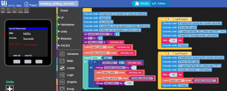

Unfortunately I don't think there is a way to post files on the forum.<br />
Other than copying and pasting the micropython output<br />
The only way is to host the file somewhere and paste the link.</p>
<p dir="auto">I would suggest the best way would be if you have a github account<br />
then make a repository with the file there and share it with us here.<br />
This would also allow for us to add it to our links of resources.</p>

<p dir="auto">This is my test program for writing and reading data to/from SD card:</p>
<p dir="auto"><img src="/assets/uploads/files/1566934254883-test_sd-read-write-resized.jpg" alt="0_1566934261928_Test_SD-Read-Write.jpg" class=" img-fluid img-markdown" /></p>
