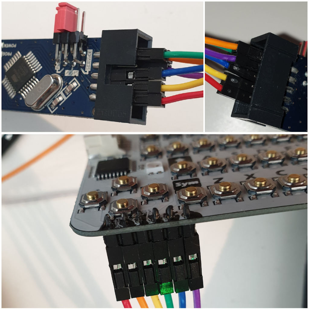

<p dir="auto">I tried to fiddle with the CardKB mega328p chip, but have troubles connecting it to the programmer, as below:</p>
<pre><code>$ avrdude  -c usbasp -p atmega328p
avrdude: error: program enable: target doesn't answer. 1
avrdude: initialization failed, rc=-1
         Double check connections and try again, or use -F to override
         this check.
avrdude done.  Thank you.
</code></pre>
<p dir="auto">The pinout I inferred is also below (leftmost square hole for MISO, then Vcc, SCK, MOSI, RESET and Ground). the black thing on the wires is conductive paint I use as temporary solder, hasn't failed me yet ;)<br />
<img src="/assets/uploads/files/1568457208985-pins-isp-cardkb-resized.jpg" alt="0_1568457206504_pins isp cardkb.jpg" class=" img-fluid img-markdown" /></p>
<p dir="auto">My question is whether the pins are connected in the right order, as I could not find any official pinout except for the photo on AliExpress which indicated it is an ISP connector on the bottom of the keyboard.</p>
<p dir="auto">If yes, I'll try soldering and changing kables or programmers to double check. I just don't have any idea if adding resistor or anything else could help in this case. Thanks for help.</p>
<p dir="auto">EDIT: I also tried connecting the GND pin to all possible pins on the programmer. Also tried slow / power jumpers on and off.</p>
<p dir="auto">Also, when I run AVRdude, the rgb led on the keyboard blinks shortly.</p>

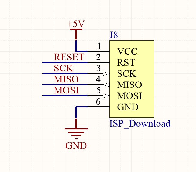

<pre><code>~  avrdude -c usbasp -p atmega328p
avrdude: AVR device initialized and ready to accept instructions
Reading | ################################################## | 100% 0.00s
avrdude: Device signature = 0x1e950f (probably m328p)
avrdude: safemode: Fuses OK (E:F9, H:D8, L:C2)
</code></pre>

<p dir="auto">CardKB</p>
<p dir="auto"><a href="https://docs.m5stack.com/#/en/unit/cardkb" target="_blank" rel="noopener noreferrer nofollow ugc">https://docs.m5stack.com/#/en/unit/cardkb</a><br />
Mega328 ISPDownload interface Pin foot definition<br />
<img src="/assets/uploads/files/1568599236040-mega328_isp.png" alt="0_1568599238551_mega328_isp.png" class=" img-fluid img-markdown" /></p>
