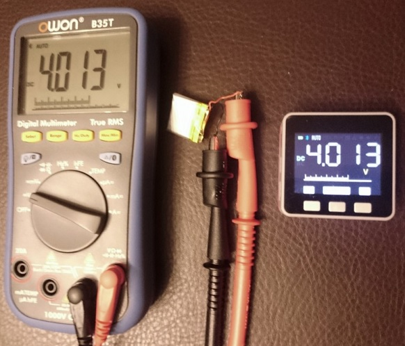

<p dir="auto">Pretty awesome looking work there !! Thanks for putting the link up.</p>
<p dir="auto">I loaded the code up but unfortunately I don't have an Owon to test it further..... Certainly tempted.....</p>
<p dir="auto">Here is photo of it in action from Reaper7's github page:</p>
<p dir="auto"><img src="/assets/uploads/files/1520652043017-0489c21c-e31e-48c7-be88-ab97db2d3f54-image.png" alt="0_1520652036121_0489c21c-e31e-48c7-be88-ab97db2d3f54-image.png" class=" img-fluid img-markdown" /></p>
