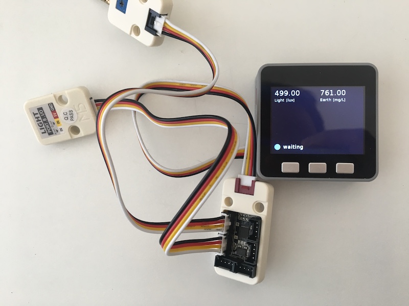

<?xml version="1.0" encoding="UTF-8"?><rss xmlns:dc="http://purl.org/dc/elements/1.1/" xmlns:content="http://purl.org/rss/1.0/modules/content/" xmlns:atom="http://www.w3.org/2005/Atom" version="2.0"><channel><title><![CDATA[Connect units to PbHUB]]></title><description><![CDATA[<p dir="auto">I am trying to connect a <code>LIGHT</code> and an <code>EARTH</code> unit to the <code>PbHUB</code>. I connected the <code>PbHUB</code> to <code>PortA</code>, the <code>EARTH</code> sensor to <code>Hub 0</code> and the <code>LIGHT</code> sensor to <code>Hub 1</code>.</p>
<p dir="auto"><img src="/assets/uploads/files/1568885497208-img_3717-resized.jpg" alt="0_1568885495578_IMG_3717.JPG" class=" img-fluid img-markdown" /></p>

<p dir="auto">I am able to read values from both sensors, however with strange behaviours. E.g. the lux value increases when it gets darker and vice versa. I guess the problem is, that I am lacking the logic of the <code>analogRead</code> function in the <code>LIGHT</code> and <code>EARTH</code> units:<br />
<a href="https://github.com/m5stack/UIFlow-Code/blob/a0dbef98fe29323d6b1837b479764fdab50c3836/units/_light.py" target="_blank" rel="noopener noreferrer nofollow ugc">https://github.com/m5stack/UIFlow-Code/blob/a0dbef98fe29323d6b1837b479764fdab50c3836/units/_light.py</a><br />
<a href="https://github.com/m5stack/UIFlow-Code/blob/a0dbef98fe29323d6b1837b479764fdab50c3836/units/_earth.py" target="_blank" rel="noopener noreferrer nofollow ugc">https://github.com/m5stack/UIFlow-Code/blob/a0dbef98fe29323d6b1837b479764fdab50c3836/units/_earth.py</a></p>
<p dir="auto">However I do not see how I would have to connect this unit correctly to the <code>PbHUB</code>. Do I have to copy paste the <code>analogRead</code> logic or is there another way to connect these units?<br />
