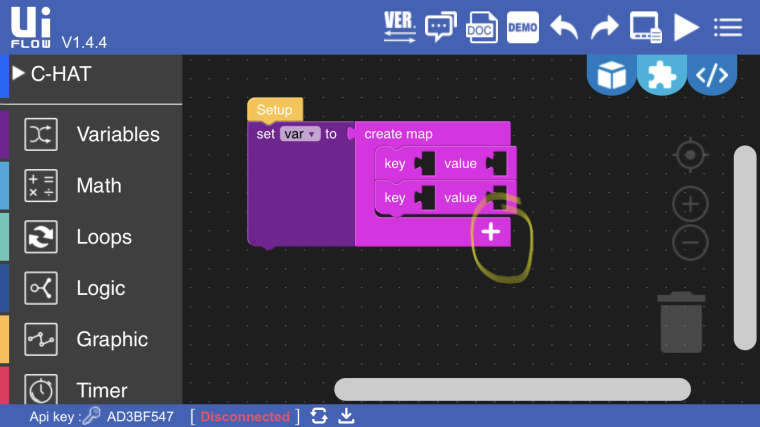

<p dir="auto">Where is the key value block, it no longer is in the map blocks. Can I please get an example of how to use one of the newer alternate blocks currently available.</p>
<p dir="auto">Isn’t it here when you press the + button in the map?</p>
<p dir="auto"><img src="/assets/uploads/files/1582151077825-9c5f45e5-2b92-4e8a-8836-4408dbedcf79-resized.jpeg" alt="0_1582151075308_9C5F45E5-2B92-4E8A-8836-4408DBEDCF79.jpeg" class=" img-fluid img-markdown" /></p>

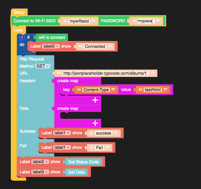

<p dir="auto"><img src="/assets/uploads/files/1570533306431-screen-shot-2019-10-08-at-12.13.33.png" alt="0_1570533301433_Screen Shot 2019-10-08 at 12.13.33.png" class=" img-fluid img-markdown" /></p>

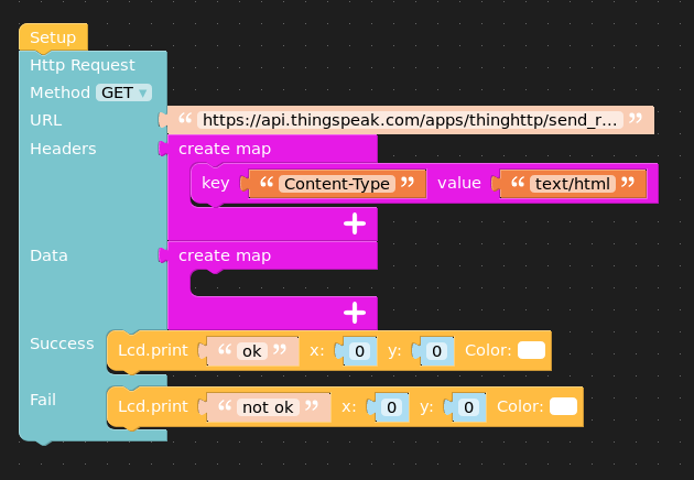

I used the following simple block</p>
<p dir="auto"><img src="/assets/uploads/files/1570255791994-d78f81f7-e728-4887-9a6d-3f4ae5163d4f-image.png" alt="0_1570255790792_d78f81f7-e728-4887-9a6d-3f4ae5163d4f-image.png" class=" img-fluid img-markdown" /> ![alt text](image url)</p>
<p dir="auto">When I run the program using the play button on UIFlow, I get the text "Ok" printed on the LCD.</p>
<p dir="auto">I get excited and I download the code into the Device, and I get to see the text " Not OK"</p>
<p dir="auto">The Python Error I get is  "list index out of range"</p>
<p dir="auto">Here is my modified code<br />
