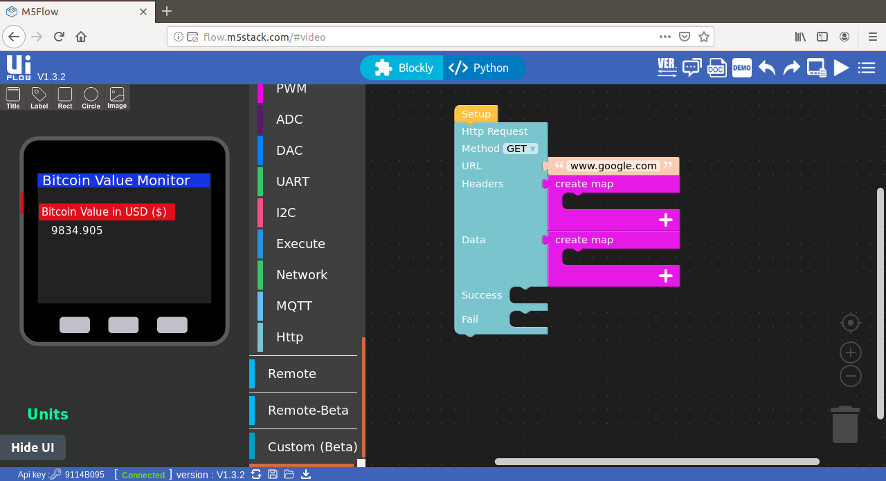

<?xml version="1.0" encoding="UTF-8"?><rss xmlns:dc="http://purl.org/dc/elements/1.1/" xmlns:content="http://purl.org/rss/1.0/modules/content/" xmlns:atom="http://www.w3.org/2005/Atom" version="2.0"><channel><title><![CDATA[HTTP Block Gives Error]]></title><description><![CDATA[<p dir="auto">How do you get started with the HTTP block? I cant do simple http requests like fetching a page from google.<br />
<img src="/assets/uploads/files/1570103595244-289ba94c-1742-46d7-b17d-e1e4413e6354-image-resized.png" alt="0_1570103593919_289ba94c-1742-46d7-b17d-e1e4413e6354-image.png" class=" img-fluid img-markdown" /></p>
<p dir="auto">My Firmware version is 1.3.2. The UI Flow version is the stable one.</p>
<p dir="auto">Please advise how to solve this issue.</p>

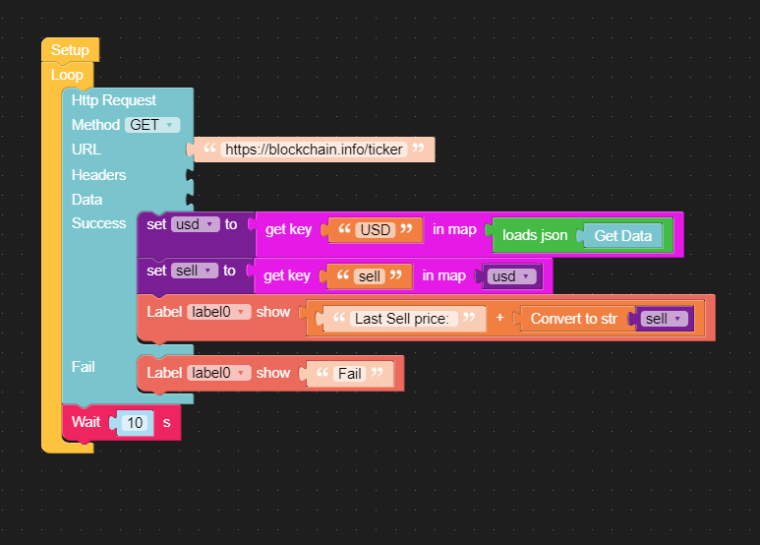

]]></description><link>https://community.m5stack.com/post/9971</link><guid isPermaLink="true">https://community.m5stack.com/post/9971</guid><dc:creator><![CDATA[GLP]]></dc:creator><pubDate>Sun, 06 Sep 2020 19:37:32 GMT</pubDate></item><item><title><![CDATA[Reply to HTTP Block Gives Error on Mon, 24 Aug 2020 12:13:27 GMT]]></title><description><![CDATA[<p dir="auto"><a class="plugin-mentions-user plugin-mentions-a" href="/user/glp" aria-label="Profile: glp">@<bdi>glp</bdi></a> Here you go. Slightly modified version of yours.<br />
<img src="/assets/uploads/files/1598271110829-screen-shot-2020-08-24-at-8.11.27-am-resized.png" alt="0_1598271097767_Screen Shot 2020-08-24 at 8.11.27 AM.png" class=" img-fluid img-markdown" /></p>
]]></description><link>https://community.m5stack.com/post/9820</link><guid isPermaLink="true">https://community.m5stack.com/post/9820</guid><dc:creator><![CDATA[world101]]></dc:creator><pubDate>Mon, 24 Aug 2020 12:13:27 GMT</pubDate></item><item><title><![CDATA[Reply to HTTP Block Gives Error on Sun, 23 Aug 2020 13:20:48 GMT]]></title><description><![CDATA[<p dir="auto">Hello, i'm a beginner of UIFlow and M5Stack, just tried to parse json from this example code, but doesn't work for me,  no json node extract,  so compare  Failed message. I'm able to download whole json data with the command LCD.Print GET DATA. Someone has success with json code samples?</p>

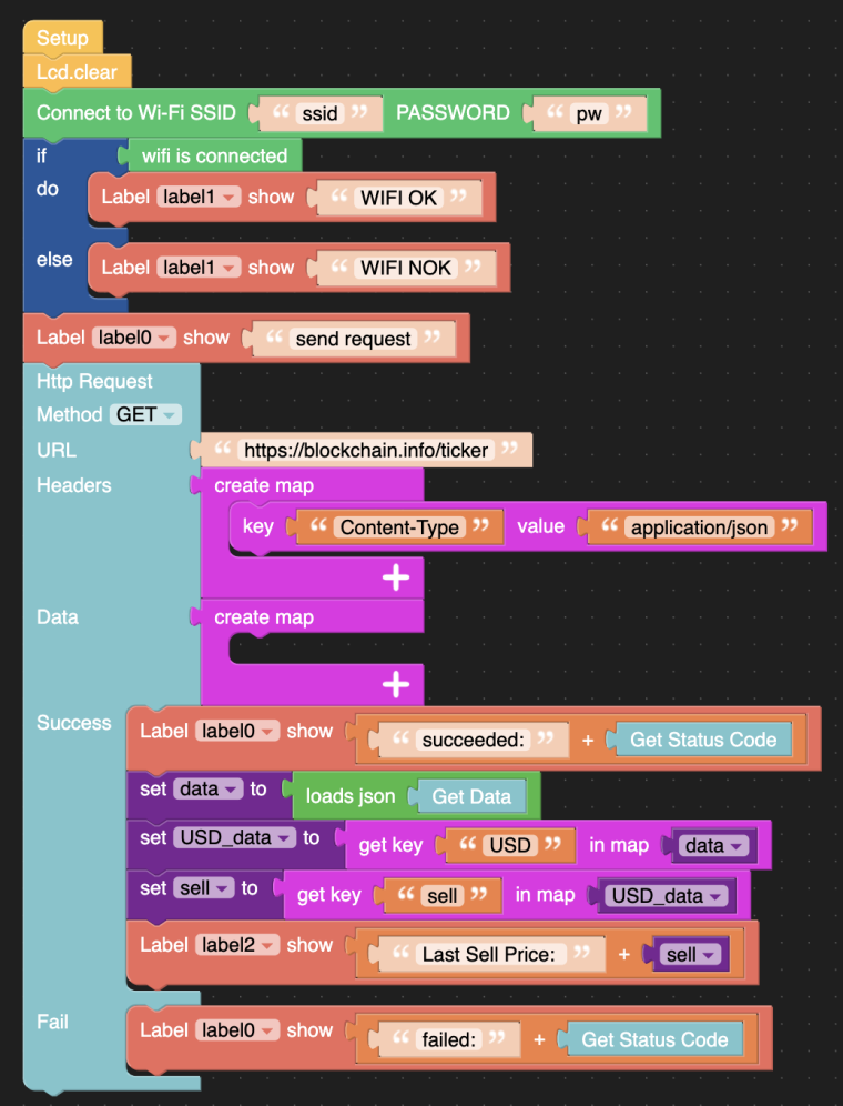

<img src="/assets/uploads/files/1570543562889-76da9dc4-61db-4a4e-8ca7-e03d1976ef77-image-resized.png" alt="0_1570543604093_76da9dc4-61db-4a4e-8ca7-e03d1976ef77-image.png" class=" img-fluid img-markdown" /></p>
<p dir="auto">Just get json format from blockchain and decode what you need ;)</p>
<p dir="auto">Enjoy</p>
<p dir="auto">SRC:<br />
<a href="https://blockchain.info/ticker" target="_blank" rel="noopener noreferrer nofollow ugc">https://blockchain.info/ticker</a></p>
