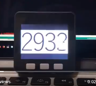

<?xml version="1.0" encoding="UTF-8"?><rss xmlns:dc="http://purl.org/dc/elements/1.1/" xmlns:content="http://purl.org/rss/1.0/modules/content/" xmlns:atom="http://www.w3.org/2005/Atom" version="2.0"><channel><title><![CDATA[Has anyone figured out a good way to update the display quickly?]]></title><description><![CDATA[<p dir="auto">I have my display showing a constantly updating number, but this number doesn't ever get erased which makes it really hard to read after a short while.<br />
I tried setting the whole display to black before doing each number but it creates a rolling effect...</p>

<p dir="auto"><img src="/assets/uploads/files/1520926065233-d60dfa1c-0589-4e68-bc06-82e52d4e2106-image.png" alt="0_1520926062432_d60dfa1c-0589-4e68-bc06-82e52d4e2106-image.png" class=" img-fluid img-markdown" /></p>

<p dir="auto">I agree with you. the fast(er) update is done with</p>
<p dir="auto">M5.Lcd.setTextColor(TFT_BLACK,TFT_WHITE);</p>

<p dir="auto">If this is the case, I first clear the dynamic line with <code>\r</code> and then write the updated string. This happens much quicker than clearing all pixels of the screen.</p>
<p dir="auto"><a class="plugin-mentions-user plugin-mentions-a" href="/user/on4aa" aria-label="Profile: on4aa">@<bdi>on4aa</bdi></a>, Can you please provide example code of the above?</p>
<p dir="auto">I have been experimenting with text quite a bit as well.  I first was drawing a rectangle the same color as the background approximately the same size as the text, before writing the line of text.  But I think this would have the same rolling effect as <a class="plugin-mentions-user plugin-mentions-a" href="/user/joeybab3" aria-label="Profile: joeybab3">@<bdi>joeybab3</bdi></a> was saying under fast update situations.</p>
<p dir="auto"><a class="plugin-mentions-user plugin-mentions-a" href="/user/joeybab3" aria-label="Profile: joeybab3">@<bdi>joeybab3</bdi></a>,  another suggestion is to provide the background color while defining the text color.  Did you try that?</p>
<p dir="auto"><code>M5.Lcd.setTextColor(TFT_BLACK,TFT_WHITE);</code></p>
<p dir="auto">I have not tested this in a fast update scenario, but from the twitter video above, it looks like what he did.</p>

<p dir="auto">This twitter user seems to have it working.......<br />
<a href="https://twitter.com/ksasao/status/970196248836755456" target="_blank" rel="noopener noreferrer nofollow ugc">https://twitter.com/ksasao/status/970196248836755456</a></p>
