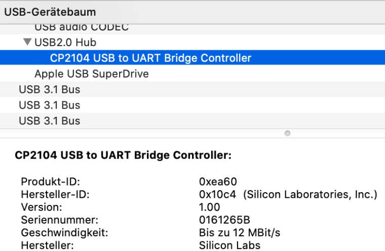

<p dir="auto">If I connected a M5Stack I saw:<br />
<img src="/assets/uploads/files/1577975616819-m5stack-resized.jpg" alt="0_1577975601066_M5Stack.jpg" class=" img-fluid img-markdown" /></p>

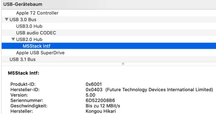

<p dir="auto">If I connected a M5StickC I saw:<br />
<img src="/assets/uploads/files/1577975723122-m5stickc-resized.jpg" alt="0_1577975705966_M5StickC.jpg" class=" img-fluid img-markdown" /></p>

<p dir="auto">You can check the loaded drivers and their versions in terminal with "sudo kextstat".</p>
<p dir="auto">I noticed that sometimes M5Stack didn't not work without "short the G0 to GND". I think that is a timing-problem at Catalina and <a href="http://esptool.py" target="_blank" rel="noopener noreferrer nofollow ugc">esptool.py</a>. It is not a problem of M5Stack- or M5StickC-Software.</p>

<p dir="auto">the solution: When programming, short the G0 to GND using the DuPont line.</p>
<p dir="auto">and ,   all most PC don't need driver with M5StickC.  But some old PC System need install FTDI driver.</p>
<p dir="auto">FTDI driver is for M5StickC,    CP2104 driver is for M5Stack Core ( like Fire BASIC M5GO)</p>
