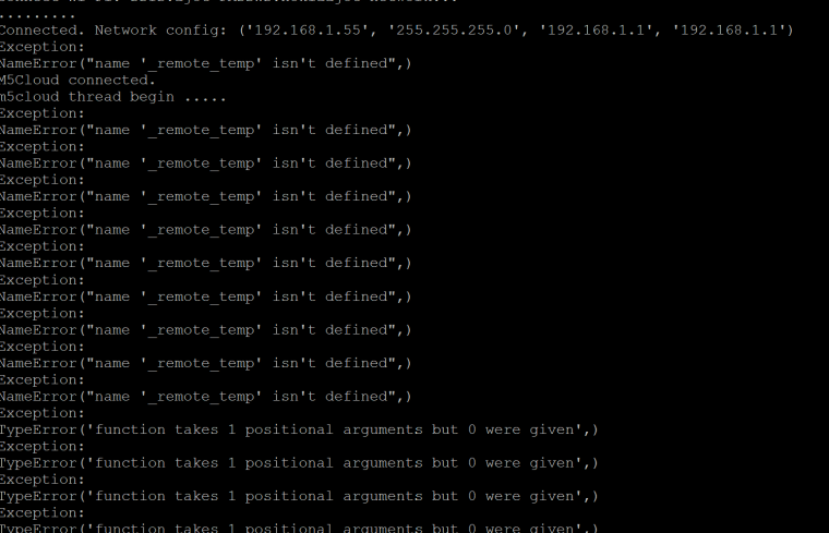

<?xml version="1.0" encoding="UTF-8"?><rss xmlns:dc="http://purl.org/dc/elements/1.1/" xmlns:content="http://purl.org/rss/1.0/modules/content/" xmlns:atom="http://www.w3.org/2005/Atom" version="2.0"><channel><title><![CDATA[UiFlow 1.4.0 - Remote &#x2F; not pulling from device]]></title><description><![CDATA[<p dir="auto">Hi,</p>
<p dir="auto">base on all tutorials / manual i am not able to push to Remote resoults from ENV.<br />
On screen all is fine i mean on Core unit also on Fire and Face, but all 3 units fail on remote ...<br />
<img src="http://ziolek.org.pl/pix/remote_fail.gif" alt="text alternatywny" class=" img-fluid img-markdown" /><br />
Remote button is working fine.</p>
<p dir="auto">And here is dump from console:<br />
<img src="/assets/uploads/files/1570452425621-acc38544-2e8b-4995-8371-984ff2535520-image-resized.png" alt="0_1570452407390_acc38544-2e8b-4995-8371-984ff2535520-image.png" class=" img-fluid img-markdown" /><br />
What is wrong ?</p>
]]></description><link>https://community.m5stack.com/topic/1370/uiflow-1-4-0-remote-not-pulling-from-device</link><generator>RSS for Node</generator><lastBuildDate>Wed, 29 Apr 2026 08:20:02 GMT</lastBuildDate><atom:link href="https://community.m5stack.com/topic/1370.rss" rel="self" type="application/rss+xml"/><pubDate>Mon, 07 Oct 2019 12:47:17 GMT</pubDate><ttl>60</ttl><item><title><![CDATA[Reply to UiFlow 1.4.0 - Remote &#x2F; not pulling from device on Mon, 07 Oct 2019 18:55:29 GMT]]></title><description><![CDATA[<p dir="auto">@mati Hmn, I think you could be correct there with the backend.<br />
Put a hold on the project and try again in a couple of days or drop a bug report on the UIFLow github page.</p>
]]></description><link>https://community.m5stack.com/post/5865</link><guid isPermaLink="true">https://community.m5stack.com/post/5865</guid><dc:creator><![CDATA[ajb2k3]]></dc:creator><pubDate>Mon, 07 Oct 2019 18:55:29 GMT</pubDate></item><item><title><![CDATA[Reply to UiFlow 1.4.0 - Remote &#x2F; not pulling from device on Mon, 07 Oct 2019 18:38:15 GMT]]></title><description><![CDATA[<p dir="auto"><a class="plugin-mentions-user plugin-mentions-a" href="/user/ajb2k3" aria-label="Profile: ajb2k3">@<bdi>ajb2k3</bdi></a> its almost 1:1 like in <a href="https://youtu.be/teR-_JKNxeE?t=201" target="_blank" rel="noopener noreferrer nofollow ugc">https://youtu.be/teR-_JKNxeE?t=201</a></p>
<p dir="auto"><img src="/assets/uploads/files/1570473258384-f15928aa-ce8d-485f-b6c9-ad4fdda3c42d-image-resized.png" alt="0_1570473257554_f15928aa-ce8d-485f-b6c9-ad4fdda3c42d-image.png" class=" img-fluid img-markdown" /></p>
<p dir="auto">i  think its working fine a week ago, but its req fresh erase / burn. With more complex code like this:<br />
<img src="/assets/uploads/files/1570473463566-2b7bbb5c-bffd-45ca-882b-bfbab08dbe69-image-resized.png" alt="0_1570473460360_2b7bbb5c-bffd-45ca-882b-bfbab08dbe69-image.png" class=" img-fluid img-markdown" /></p>
<p dir="auto">remote code is not working at all, also the remote URL is not generating.</p>
<p dir="auto">I think this is some backend problem.</p>
]]></description><link>https://community.m5stack.com/post/5864</link><guid isPermaLink="true">https://community.m5stack.com/post/5864</guid><dc:creator><![CDATA[OyczE]]></dc:creator><pubDate>Mon, 07 Oct 2019 18:38:15 GMT</pubDate></item><item><title><![CDATA[Reply to UiFlow 1.4.0 - Remote &#x2F; not pulling from device on Mon, 07 Oct 2019 18:25:09 GMT]]></title><description><![CDATA[<p dir="auto">@mati Don't use Set variable to query a value, use change.<br />
Set is used before the initial loop to set the initial value for the variable.</p>
]]></description><link>https://community.m5stack.com/post/5863</link><guid isPermaLink="true">https://community.m5stack.com/post/5863</guid><dc:creator><![CDATA[ajb2k3]]></dc:creator><pubDate>Mon, 07 Oct 2019 18:25:09 GMT</pubDate></item><item><title><![CDATA[Reply to UiFlow 1.4.0 - Remote &#x2F; not pulling from device on Mon, 07 Oct 2019 18:20:13 GMT]]></title><description><![CDATA[<p dir="auto">@mati I have been trying but the server has stopped working</p>
]]></description><link>https://community.m5stack.com/post/5862</link><guid isPermaLink="true">https://community.m5stack.com/post/5862</guid><dc:creator><![CDATA[ajb2k3]]></dc:creator><pubDate>Mon, 07 Oct 2019 18:20:13 GMT</pubDate></item><item><title><![CDATA[Reply to UiFlow 1.4.0 - Remote &#x2F; not pulling from device on Mon, 07 Oct 2019 18:16:39 GMT]]></title><description><![CDATA[<p dir="auto"><a class="plugin-mentions-user plugin-mentions-a" href="/user/ajb2k3" aria-label="Profile: ajb2k3">@<bdi>ajb2k3</bdi></a> one step forward<br />
Exception:<br />
TypeError("'int' object isn't callable",)</p>
<p dir="auto">could you test it as well ?</p>
]]></description><link>https://community.m5stack.com/post/5861</link><guid isPermaLink="true">https://community.m5stack.com/post/5861</guid><dc:creator><![CDATA[OyczE]]></dc:creator><pubDate>Mon, 07 Oct 2019 18:16:39 GMT</pubDate></item><item><title><![CDATA[Reply to UiFlow 1.4.0 - Remote &#x2F; not pulling from device on Mon, 07 Oct 2019 18:01:17 GMT]]></title><description><![CDATA[<p dir="auto">@mati try creating a variable _remote_temp and set to 0</p>
]]></description><link>https://community.m5stack.com/post/5860</link><guid isPermaLink="true">https://community.m5stack.com/post/5860</guid><dc:creator><![CDATA[ajb2k3]]></dc:creator><pubDate>Mon, 07 Oct 2019 18:01:17 GMT</pubDate></item><item><title><![CDATA[Reply to UiFlow 1.4.0 - Remote &#x2F; not pulling from device on Mon, 07 Oct 2019 17:56:39 GMT]]></title><description><![CDATA[<p dir="auto"><a class="plugin-mentions-user plugin-mentions-a" href="/user/ajb2k3" aria-label="Profile: ajb2k3">@<bdi>ajb2k3</bdi></a> yee was bad now its fixed</p>
