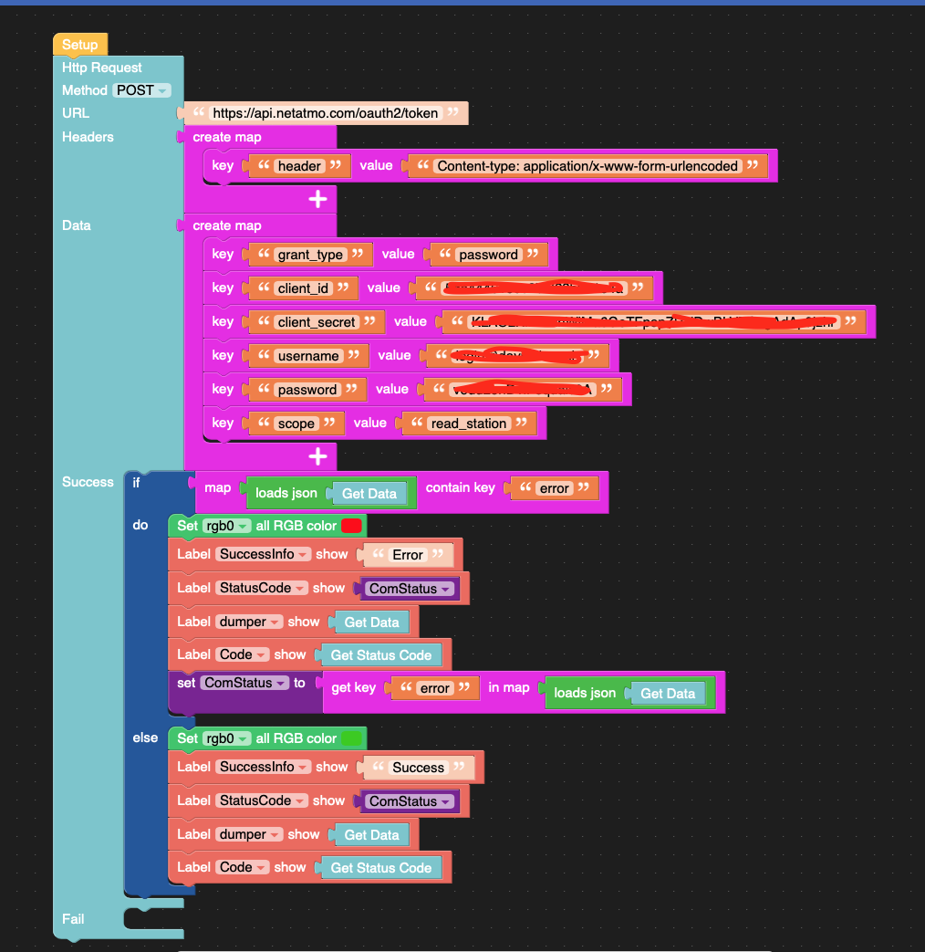

<p dir="auto">I tried it with the new http request block but I get the error "invalid_request, Invalid grant_type parameter or parameter missing"</p>
<p dir="auto">What could be the problem?</p>

is it possible to share you code ? interest by this code.<br />
for me the UIFlow not work  with my M5 stack so I use only arduino ide interface.<br />
Thx</p>

I have no problem getting a correct response when working with Postman or directly with Python, but I'm not able to figure out what's wrong in UiFlow.<br />
Would you perhaps have time to elaborate on how you have managed to fix it in "python portion" of the UiFlow if you still remember?<br />
Sorry again for the inconvenience.<br />
Best regards.</p>

<p dir="auto"><a class="plugin-mentions-user plugin-mentions-a" href="/user/ajb2k3" aria-label="Profile: ajb2k3">@<bdi>ajb2k3</bdi></a> hm thx. But I'm not familiar with github. Maybe you can submit it for me?<br />
Done.</p>

]]></description><link>https://community.m5stack.com/post/5981</link><guid isPermaLink="true">https://community.m5stack.com/post/5981</guid><dc:creator><![CDATA[dblooom]]></dc:creator><pubDate>Tue, 15 Oct 2019 12:24:03 GMT</pubDate></item><item><title><![CDATA[Reply to http request to netatmo fails with error (solved!) on Tue, 15 Oct 2019 10:19:19 GMT]]></title><description><![CDATA[<p dir="auto"><a class="plugin-mentions-user plugin-mentions-a" href="/user/dblooom" aria-label="Profile: dblooom">@<bdi>dblooom</bdi></a> please post this as a bug report on the UIFlow github page as this is important enough for immediate attention</p>
]]></description><link>https://community.m5stack.com/post/5977</link><guid isPermaLink="true">https://community.m5stack.com/post/5977</guid><dc:creator><![CDATA[ajb2k3]]></dc:creator><pubDate>Tue, 15 Oct 2019 10:19:19 GMT</pubDate></item><item><title><![CDATA[Reply to http request to netatmo fails with error (solved!) on Tue, 15 Oct 2019 09:39:05 GMT]]></title><description><![CDATA[<p dir="auto">Ok, could figure it out. The http-req sends data as JSON but Netatmo needs it as "data". So I could change it in Phyton code but can't do it in blocky.</p>
<p dir="auto">@devs: So it would be nice to have two different slots in the http-reqthing: one for json-data and one for data. Or an option to switch it.</p>

]]></description><link>https://community.m5stack.com/post/5975</link><guid isPermaLink="true">https://community.m5stack.com/post/5975</guid><dc:creator><![CDATA[dblooom]]></dc:creator><pubDate>Tue, 15 Oct 2019 08:47:39 GMT</pubDate></item><item><title><![CDATA[Reply to http request to netatmo fails with error (solved!) on Tue, 15 Oct 2019 01:37:16 GMT]]></title><description><![CDATA[<p dir="auto"><a class="plugin-mentions-user plugin-mentions-a" href="/user/dblooom" aria-label="Profile: dblooom">@<bdi>dblooom</bdi></a> The header option should be like it.<br />

]]></description><link>https://community.m5stack.com/post/5971</link><guid isPermaLink="true">https://community.m5stack.com/post/5971</guid><dc:creator><![CDATA[ozbk]]></dc:creator><pubDate>Tue, 15 Oct 2019 01:37:16 GMT</pubDate></item><item><title><![CDATA[Reply to http request to netatmo fails with error (solved!) on Mon, 14 Oct 2019 18:00:19 GMT]]></title><description><![CDATA[<p dir="auto">thx, but this seems not to be the solution (I tested it anyway). Grant-Type "password" is correct afik.</p>
]]></description><link>https://community.m5stack.com/post/5966</link><guid isPermaLink="true">https://community.m5stack.com/post/5966</guid><dc:creator><![CDATA[dblooom]]></dc:creator><pubDate>Mon, 14 Oct 2019 18:00:19 GMT</pubDate></item><item><title><![CDATA[Reply to http request to netatmo fails with error (solved!) on Mon, 14 Oct 2019 17:01:31 GMT]]></title><description><![CDATA[<p dir="auto">May sound stupid but have you tried</p>

</code></pre>
<p dir="auto">Perhaps your code should be key "grant_type" value authorization_code</p>
]]></description><link>https://community.m5stack.com/post/5965</link><guid isPermaLink="true">https://community.m5stack.com/post/5965</guid><dc:creator><![CDATA[ajb2k3]]></dc:creator><pubDate>Mon, 14 Oct 2019 17:01:31 GMT</pubDate></item></channel></rss>
