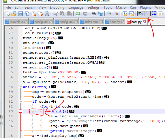

Have you checked your code with whitespace enabled?<br />
copy your code in notepad++ and check it for incorrect tabbings most of my problems came from wrong whtespacing</p>
<p dir="auto"><img src="/assets/uploads/files/1572071917679-b2d12d67-0f62-475d-84d6-10eeb8cf611d-image.png" alt="0_1572071889224_b2d12d67-0f62-475d-84d6-10eeb8cf611d-image.png" class=" img-fluid img-markdown" /></p>
