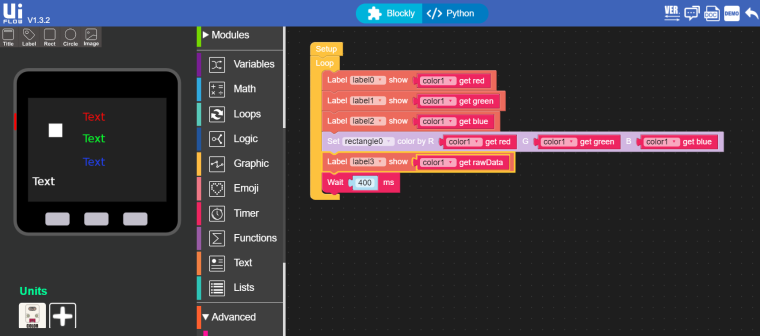

<p dir="auto">I'm a beginner, and I don't know if I did anything wrong.<br />
Please have a look at my picture.</p>
<p dir="auto">thanks alf</p>

<p dir="auto">255 it looks like you are only reading one channel. you need to read all three channels to get the full colour value of 255.255.255 .</p>
