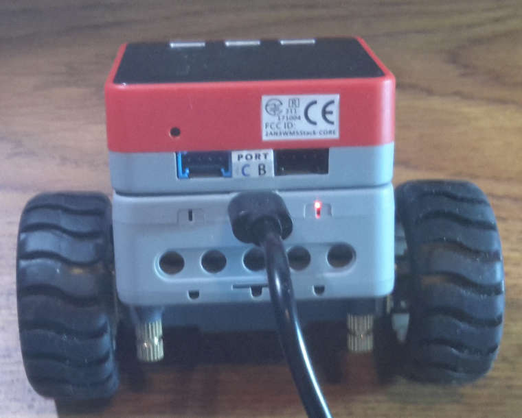

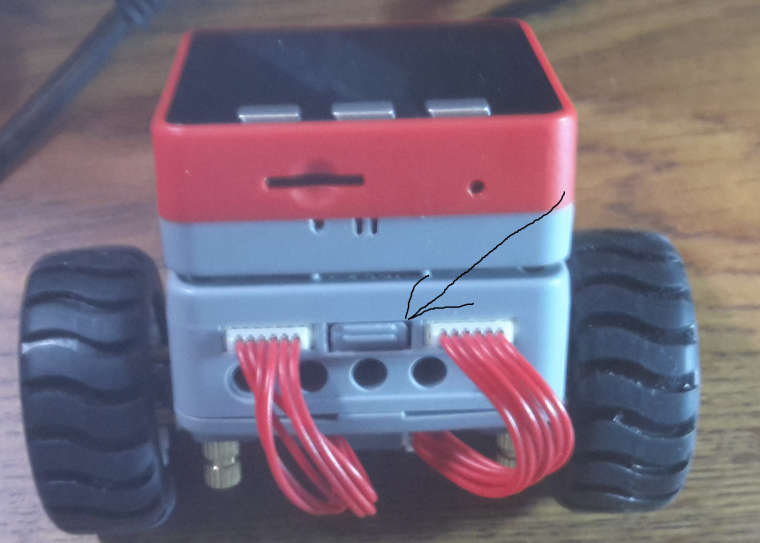

      @m5stack I don't think it is working correctly. When I push the button on the base, as indicated by the arrow on the picture, nothing happens. When I have the base plugged into USB, the red light is steady on. The top of the base feels very warm.1_1573516836915_M5Stack-bala-charging.jpg 0_1573516836914_M5Stack-bala-backside.jpg

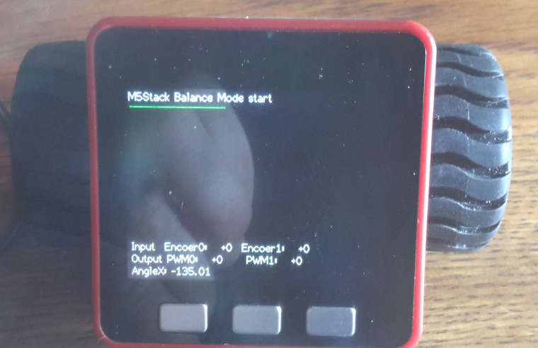

          @m5stack I thought the unit was preloaded with a program. When I turn on the Fire part, it looks like it is trying to start a program.
          I looks like it can't do anything because it is not receiving any data from the base unit. The base unit is not powering up (no green leds).

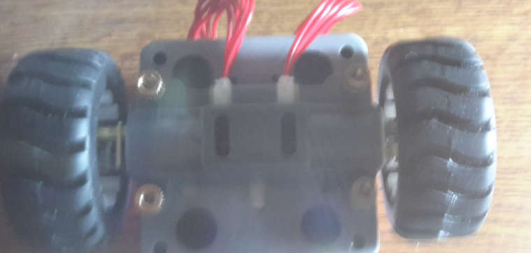

          ![0_1573526893942_M5Stack-bala-bottom.jpg](/assets/uploads/files/1573526896639-m5stack-bala-bottom-resized.j
          H 1 Reply Last reply Reply Quote 0
          • H Offline
            Happy Hippo @Happy Hippo
            @happy-hippo didn't load this picture in the last post for some reason:

              @happy-hippo you need turn on the bottom power when you put the Fire on the top site. if click the bottom power button ,the Green LED still not lighting , maybe should be charge it.

                  @lukasmaximus Thanks, but I tried that already. No Power. My original question is what does the solid red LED on the base mean when it is plugged in? Charging? Finished charging? Charging problem? When I charge the Fire by itself, it blinks while charging. I've had the base plugged in for many hours but the LED is solid red. I took apart the base to see if anything was disconnected. There is not anything obvious wrong. The battery is very sticky though. Is it supposed to be?
                  How do I get a replacement? As this is not usable.
