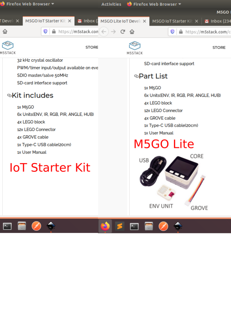

                  I agree with this argument that there are problems with the platform. Additionally, the store is also in disarray. Look at the included parts in the M5GO Lite and M5Go IoT Kit. They both are same, but there is a $16 price difference(Lite is cheaper). All of it points to one fundamental issue, lack of attention to detail. 0_1574915089049_bitmap.png
