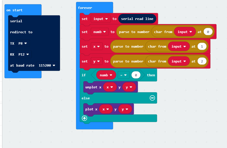

<p dir="auto">Here is the Micro-Bit code ;</p>
<p dir="auto"><img src="/assets/uploads/files/1577130162698-image1-resized.jpg" alt="0_1577130157915_Image1.jpg" class=" img-fluid img-markdown" /></p>

<p dir="auto">On the M5; button A moves left, button C moves right and button B toggles the led, this shows on Micro-Bit and M5</p>
