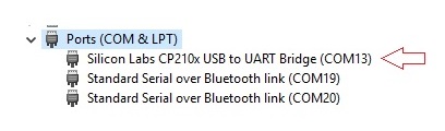

]]></description><link>https://community.m5stack.com/post/789</link><guid isPermaLink="true">https://community.m5stack.com/post/789</guid><dc:creator><![CDATA[daslolo]]></dc:creator><pubDate>Tue, 10 Apr 2018 03:18:11 GMT</pubDate></item><item><title><![CDATA[Reply to UART driver breaks on each restart on Mon, 09 Apr 2018 22:30:18 GMT]]></title><description><![CDATA[<p dir="auto"><a class="plugin-mentions-user plugin-mentions-a" href="/user/daslolo" aria-label="Profile: daslolo">@<bdi>daslolo</bdi></a> In Device Manager, you should see the Silicon Labs driver listed BUT ONLY when the M5Stack is connected to the USB. If it is not listed when M5 is connected then there is likely a problem relating to the driver/usb cable/hub/etc.  Something is interfering with it? Windows maybe. Windows updates....</p>
<p dir="auto">To me the picture you attached suggests one of your usb hubs is not properly supported, but i don't know if thats where your M5 is connected (best not) and it doesn't tell me about the state of the Silicon Labs driver.</p>
<p dir="auto">You seemed to have a working version the other day.... consider if something has changed since then.</p>
<p dir="auto">Good luck.</p>
<p dir="auto"><img src="/assets/uploads/files/1523313015253-m5stack-devicemanager.jpg" alt="0_1523313011966_M5Stack-DeviceManager.jpg" class=" img-fluid img-markdown" /></p>

<img src="https://i.imgur.com/urNQElT.png" alt="alt text" class=" img-fluid img-markdown" /></p>
