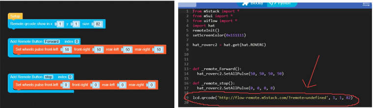

<a class="plugin-mentions-user plugin-mentions-a" href="/user/ajb2k3" aria-label="Profile: ajb2k3">@<bdi>ajb2k3</bdi></a><br />
<img src="/assets/uploads/files/1579120099636-remote-resized.jpg" alt="0_1579120095882_remote.jpg" class=" img-fluid img-markdown" /><br />
As you can see on picture, Python code doesn't show the complete URL.<br />
I think full link is generated by server.<br />
I tried to upload the same program in my M5stack Fire, scanned the QRcode but it doesn't work with M5StickC after.</p>
