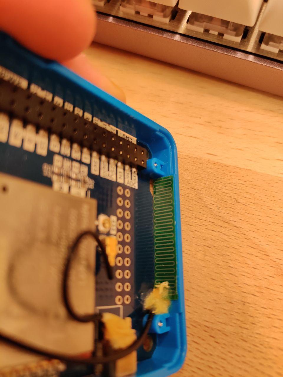

<p dir="auto">Does anyone know what is the resonating frequency of the internal PCB antenna of the LoRaWan module?<br />
<img src="/assets/uploads/files/1579010223675-photo_2020-01-13_09-59-00-resized.jpg" alt="internal_antenna.jpg" class=" img-fluid img-markdown" /></p>
<p dir="auto">Thanks.</p>
]]></description><link>https://community.m5stack.com/topic/1618/lorawan-module-internal-antenna</link><generator>RSS for Node</generator><lastBuildDate>Fri, 01 May 2026 07:12:59 GMT</lastBuildDate><atom:link href="https://community.m5stack.com/topic/1618.rss" rel="self" type="application/rss+xml"/><pubDate>Tue, 14 Jan 2020 13:58:47 GMT</pubDate><ttl>60</ttl><item><title><![CDATA[Reply to LoRaWan module internal antenna on Wed, 11 Mar 2020 09:38:25 GMT]]></title><description><![CDATA[<p dir="auto">I used an antenna analyzer and this is what I got:<br />
<img src="/assets/uploads/files/1583919274876-lorawan_internal_antenna-resized.jpg" alt="LoRaWAN Module internal antenna analysis" class=" img-fluid img-markdown" /><br />
There are 3 spikes around the following frequencies:</p>
<ul>
<li>610 MHz</li>
<li>820 MHz</li>
<li>2300 MHz</li>
</ul>
]]></description><link>https://community.m5stack.com/post/7715</link><guid isPermaLink="true">https://community.m5stack.com/post/7715</guid><dc:creator><![CDATA[Beetix]]></dc:creator><pubDate>Wed, 11 Mar 2020 09:38:25 GMT</pubDate></item></channel></rss>
