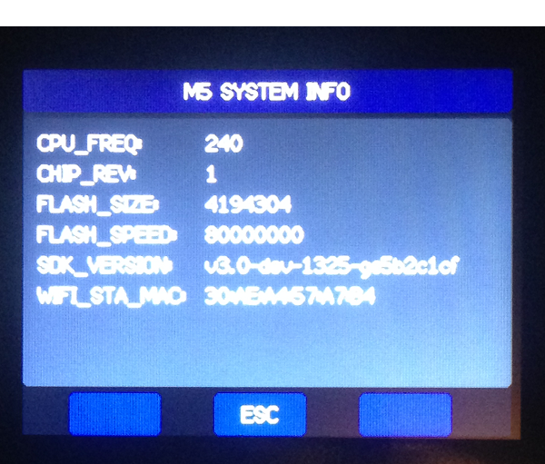

If you get the model with 4 Mb PSRAM &amp; MPU9250 then you will have the latest chip available at this time in the M5Stack range - the Expressif ESP32-DOWDQ6 WROVER.</p>
<p dir="auto">So if I run a code test to verify the CHIP REVISION number on my "M5Stack with 4Mb PSRAM" , the test reports - "Chip Rev  1".</p>
<p dir="auto">So if you get that model, you can be sure its Rev 1.</p>
<p dir="auto"><img src="/assets/uploads/files/1523297832732-system-info.png" alt="0_1523297824966_System Info.png" class=" img-fluid img-markdown" /></p>

]]></description><link>https://community.m5stack.com/post/781</link><guid isPermaLink="true">https://community.m5stack.com/post/781</guid><dc:creator><![CDATA[danIoT]]></dc:creator><pubDate>Mon, 09 Apr 2018 15:37:33 GMT</pubDate></item><item><title><![CDATA[Reply to M5Stack ESP32 revision on Sat, 07 Apr 2018 00:57:01 GMT]]></title><description><![CDATA[<p dir="auto"><a class="plugin-mentions-user plugin-mentions-a" href="/user/daslolo" aria-label="Profile: daslolo">@<bdi>daslolo</bdi></a></p>
