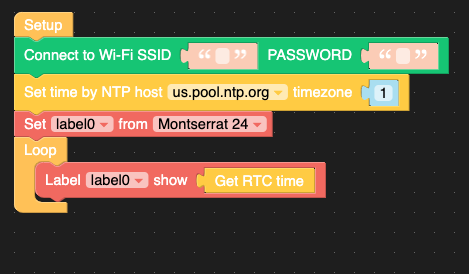

]]></description><link>https://community.m5stack.com/post/12706</link><guid isPermaLink="true">https://community.m5stack.com/post/12706</guid><dc:creator><![CDATA[sj3fk3]]></dc:creator><pubDate>Sat, 27 Feb 2021 19:40:58 GMT</pubDate></item><item><title><![CDATA[Reply to How to make RTC clock with NTP on Thu, 14 Jan 2021 08:26:55 GMT]]></title><description><![CDATA[<p dir="auto">I recently uploaded an NTP RTC example for UIFLow 1.7.<br />
Where has that gone?<br />
<img src="/assets/uploads/files/1610612811375-rtcexamp.png" alt="0_1610612797712_RTCexamp.png" class=" img-fluid img-markdown" /></p>
]]></description><link>https://community.m5stack.com/post/11739</link><guid isPermaLink="true">https://community.m5stack.com/post/11739</guid><dc:creator><![CDATA[ajb2k3]]></dc:creator><pubDate>Thu, 14 Jan 2021 08:26:55 GMT</pubDate></item><item><title><![CDATA[Reply to How to make RTC clock with NTP on Wed, 13 Jan 2021 16:31:32 GMT]]></title><description><![CDATA[<p dir="auto">Same here. The M5 Docs are a nightmare!!<br />
