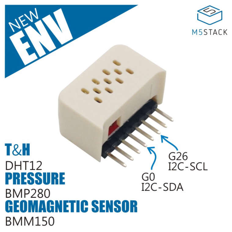

]]></description><link>https://community.m5stack.com/topic/1637/how-to-connect-tof-sensor-to-protohat</link><generator>RSS for Node</generator><lastBuildDate>Wed, 29 Apr 2026 16:18:32 GMT</lastBuildDate><atom:link href="https://community.m5stack.com/topic/1637.rss" rel="self" type="application/rss+xml"/><pubDate>Mon, 20 Jan 2020 14:10:19 GMT</pubDate><ttl>60</ttl><item><title><![CDATA[Reply to How to connect ToF sensor to ProtoHat on Wed, 22 Jan 2020 02:04:44 GMT]]></title><description><![CDATA[<p dir="auto">HI <a class="plugin-mentions-user plugin-mentions-a" href="/user/andreaf" aria-label="Profile: AndreaF">@<bdi>AndreaF</bdi></a> the space is a little tight, but perhaps you can put it in sideways and solder things to the right place via a few extra wires. As you can see in the picture of env hat below, the SDA of your TOF module should be connected to pin G0 and the SCL should be connected to G26 <img src="/assets/uploads/files/1579658679155-env_hat_01-resized.jpg" alt="0_1579658678840_env_hat_01.jpg" class=" img-fluid img-markdown" /></p>
