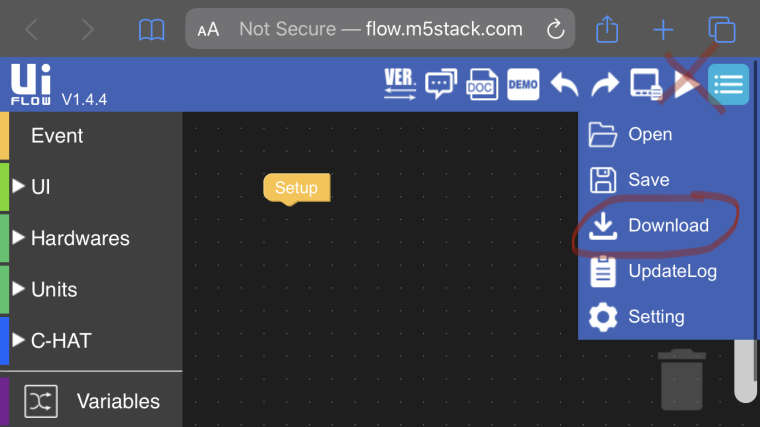

<blockquote>
<p dir="auto">Error:MQTT need,download...</p>
</blockquote>
<p dir="auto">When using MQTT, you need to download the program to your device. You can’t just run your program with the play button.</p>
<p dir="auto"><img src="/assets/uploads/files/1580040036953-1218cede-fb01-41df-89b9-ebc39cac146f-resized.jpeg" alt="0_1580040034321_1218CEDE-FB01-41DF-89B9-EBC39CAC146F.jpeg" class=" img-fluid img-markdown" /></p>
