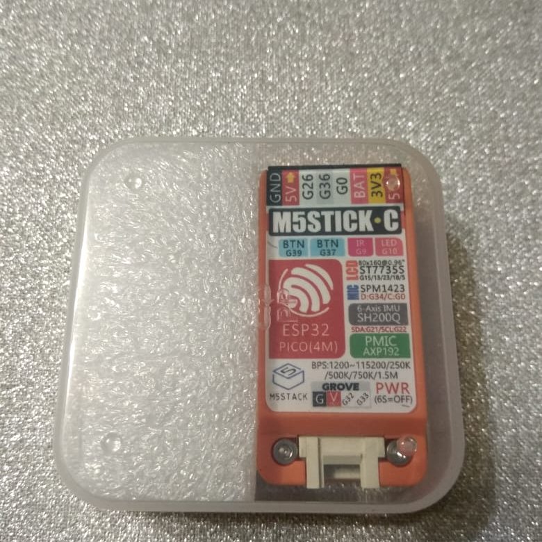

<p dir="auto">I have the very first m5stickC from the <a href="https://twitter.com/m5stack/status/1103979330848374784?lang=en" target="_blank" rel="noopener noreferrer nofollow ugc">$1 limited trial version</a>. The way mine operates is that when  it is off (long hold the power button for 6 seconds), there is ~3.8 Volts on the top Extendable Socket 5V Out pin and ~3.8 Volts on the Grove connector. When powered on, it's ~5 Volts on both. Whether this is correct or not, I have no idea. My guess is that power on those ports when the m5stickC is off is due to the internal battery.  If I measure the internal battery voltage using a uiFlow program, then power off the m5StickC and read the voltage of the  Extendable Socket with a multimeter, they are about the same.</p>
<p dir="auto">The m5stickC has gone through several hardware revisions per the Version Change table on this <a href="https://docs.m5stack.com/#/en/core/m5stickc" target="_blank" rel="noopener noreferrer nofollow ugc">link</a>, but there is not a lot of detail.</p>
<p dir="auto">Mine (SH200Q version) looks like this one and doesn't even have the two screw mounting holes in the back near the grove connector.<br />
<img src="https://pbs.twimg.com/media/D22UWmqWoAE_k1Y?format=jpg&amp;name=900x900" alt="alt text" class=" img-fluid img-markdown" /></p>
<p dir="auto">These must be the two newer versions. The picture shows two different back labels<br />
<img src="https://pbs.twimg.com/media/EPFFssRUcAA9s1N?format=jpg&amp;name=large" alt="alt text" class=" img-fluid img-markdown" /></p>
