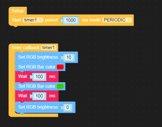

<p dir="auto">Same problem occurs with LED and with 3 different M5Stack units.<br />
Try it out and you will see that after some blinking phase it will stuck up in a permanent light.</p>
<p dir="auto"><img src="/assets/uploads/files/1581765876421-unbenanntes-bild.png" alt="0_1581765871734_Unbenanntes Bild.png" class=" img-fluid img-markdown" /></p>
<p dir="auto">I think that is a big problem...</p>
<p dir="auto">I have no issues with this flow either. It's been running for more than 20 minutes along with the beep flow on my other m5stack.</p>

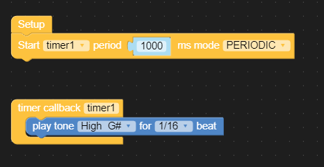

<p dir="auto">:-)</p>
<p dir="auto">Of course it is the same behavior.<br />
Try it out yourself!<br />
Run the program and wait for some beeps and you will hear a continues tone.<br />
Its obviously a bug.</p>
<p dir="auto"><img src="/assets/uploads/files/1581763638195-unbenanntes-bild.png" alt="0_1581763635467_Unbenanntes Bild.png" class=" img-fluid img-markdown" /></p>
<p dir="auto">I tested this exact flow and let it run for over 20 minutes and I'm still getting beep every 1 second. I have no issues with this flow on the M5Stack Core Grey and M5Stack Fire. I'm using uiFlow 1.4.4 and firmware v1.4.4.</p>

<p dir="auto">This flow has issues because it's trying to fire a timer callback at the same time as the 1 second wait, which causes a blocking function. I do get a continuous beep as you describe, but I don't think it's a bug. I would consider it bad code design because you have two functions at 1 second firing at the same time, which causes blocking. You really only need the timer and not the 1 second wait function to achieve a beep ever 1 second.</p>

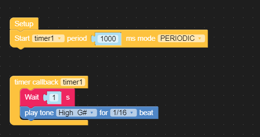

<p dir="auto">This Code generates no sound or an endless sound but not the expected 1/16 beep each second</p>
<p dir="auto"><img src="/assets/uploads/files/1581454696531-unbenanntes-bild.png" alt="0_1581454695356_Unbenanntes Bild.png" class=" img-fluid img-markdown" /></p>
