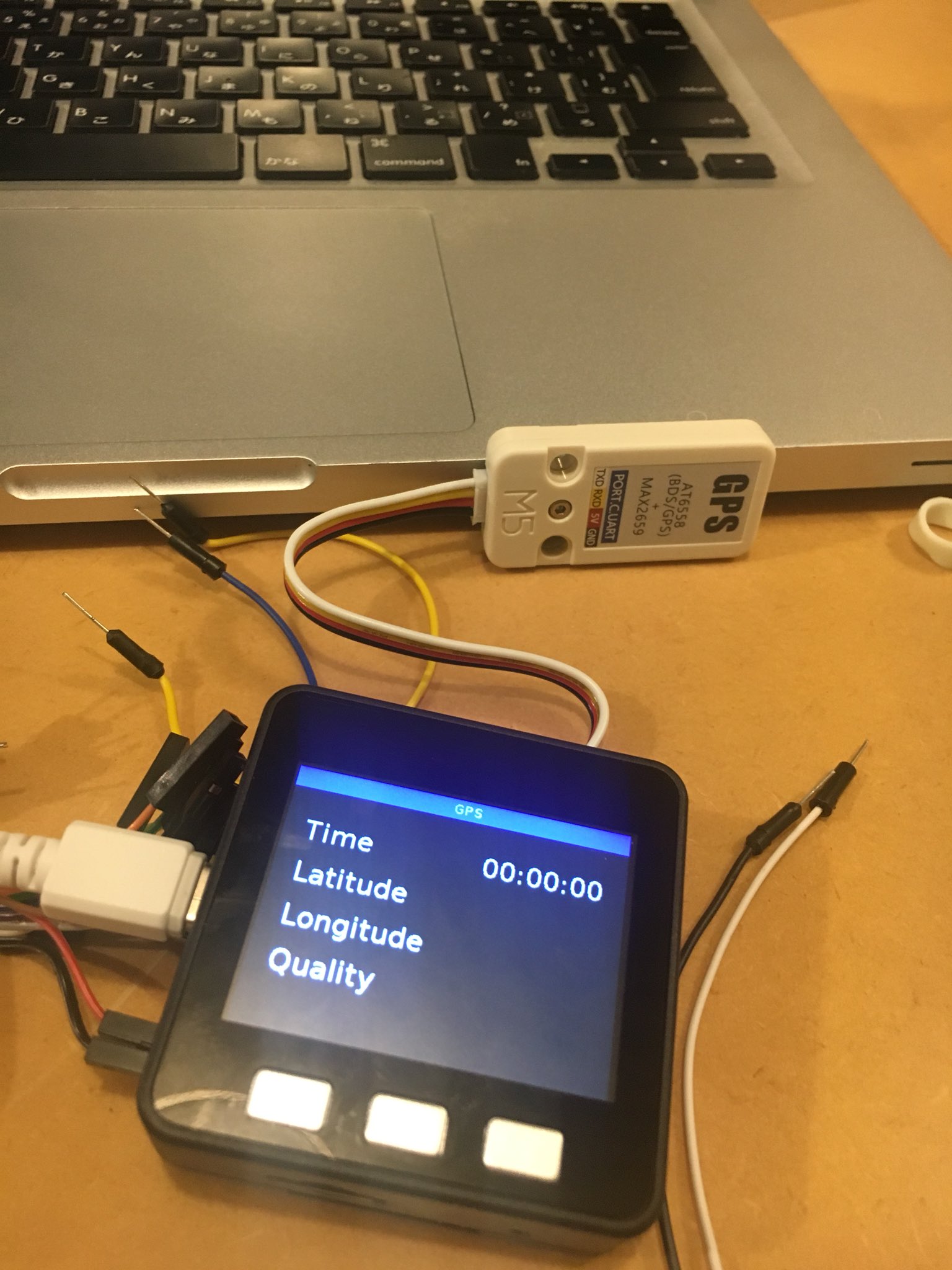

<?xml version="1.0" encoding="UTF-8"?><rss xmlns:dc="http://purl.org/dc/elements/1.1/" xmlns:content="http://purl.org/rss/1.0/modules/content/" xmlns:atom="http://www.w3.org/2005/Atom" version="2.0"><channel><title><![CDATA[GPS unit isn&#x27;t work with M5Stack Basic]]></title><description><![CDATA[<p dir="auto">HI! I want to use GPS unit with M5Stack Basic or GRAY on UIflow.</p>
<p dir="auto">I referred to these but did not resolve.</p>
<ol>
<li>(<a href="http://forum.m5stack.com/topic/1519/m5stack-fire-gps-uiflow-sintax-error-why" target="_blank" rel="noopener noreferrer nofollow ugc">http://forum.m5stack.com/topic/1519/m5stack-fire-gps-uiflow-sintax-error-why</a>)<br />
I tried to use outdoor location. And I changed another device.<br />
(m5Stack baisc → m5Stack Gray).</li>
<li>(<a href="https://twitter.com/inchoXD/status/1231543226726678529" target="_blank" rel="noopener noreferrer nofollow ugc">https://twitter.com/inchoXD/status/1231543226726678529</a>)Post on Japanese<br />
I tried to connect jump line like this.</li>
</ol>
<p dir="auto"><img src="/assets/uploads/files/1582467068915-erdscqou0aa0pm8-resized.jpeg" alt="0_1582467021753_ERdSCQoU0AA0pm8.jpeg" class=" img-fluid img-markdown" /></p>
<p dir="auto">But when I tried with arduino ide use TinyGPS++ library that works.</p>
<p dir="auto">I apologize not good English.</p>
]]></description><link>https://community.m5stack.com/topic/1723/gps-unit-isn-t-work-with-m5stack-basic</link><generator>RSS for Node</generator><lastBuildDate>Thu, 14 May 2026 07:48:09 GMT</lastBuildDate><atom:link href="https://community.m5stack.com/topic/1723.rss" rel="self" type="application/rss+xml"/><pubDate>Sun, 23 Feb 2020 14:12:40 GMT</pubDate><ttl>60</ttl><item><title><![CDATA[Reply to GPS unit isn&#x27;t work with M5Stack Basic on Thu, 27 Feb 2020 04:55:36 GMT]]></title><description><![CDATA[<p dir="auto">It seems there may be compatibility issues since uiflow firmware version 1.4.0 <a href="http://forum.m5stack.com/topic/1388/gps-data" target="_blank" rel="noopener noreferrer nofollow ugc">http://forum.m5stack.com/topic/1388/gps-data</a> try to downgrade your firmware and retry your code</p>
