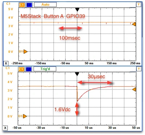

]]></description><link>https://community.m5stack.com/topic/174/m5-btna-waspressed-conflicts-with-wifi</link><generator>RSS for Node</generator><lastBuildDate>Wed, 29 Apr 2026 08:40:25 GMT</lastBuildDate><atom:link href="https://community.m5stack.com/topic/174.rss" rel="self" type="application/rss+xml"/><pubDate>Tue, 17 Apr 2018 18:53:11 GMT</pubDate><ttl>60</ttl><item><title><![CDATA[Reply to M5.BtnA.wasPressed() conflicts with WiFi? on Tue, 17 Jan 2023 20:30:57 GMT]]></title><description><![CDATA[<p dir="auto">The cause is the ESP32 bug.</p>
<p dir="auto">M5Stack Community :<br />
M5.BtnA.wasPressed() conflicts with WiFi<br />
<a href="https://forum.m5stack.com/topic/3262/m5-btna-waspressed-conflicts-with-wifi" target="_blank" rel="noopener noreferrer nofollow ugc">https://forum.m5stack.com/topic/3262/m5-btna-waspressed-conflicts-with-wifi</a></p>
<p dir="auto">This is a report of measures for the A button of M5Stack and the B button of M5Stick C to operate without permission.<br />
ButtonA on M5Stack does not work properly : May 02, 2021</p>
<p dir="auto">void setup(){<br />
WiFi.begin();<br />
WiFi.setSleep(false);<br />
}</p>
<p dir="auto">or</p>
<p dir="auto">#include &lt;driver/adc.h&gt;<br />
void setup(){<br />
adc_power_acquire(); // ADC Power ON</p>
<p dir="auto">:</p>
<p dir="auto">blog :<br />
ButtonA on M5Stack does not work properly : May 02, 2021<br />
<a href="https://macsbug.wordpress.com/2021/05/02/buttona-on-m5stack-does-not-work-properly/" target="_blank" rel="noopener noreferrer nofollow ugc">https://macsbug.wordpress.com/2021/05/02/buttona-on-m5stack-does-not-work-properly/</a></p>
