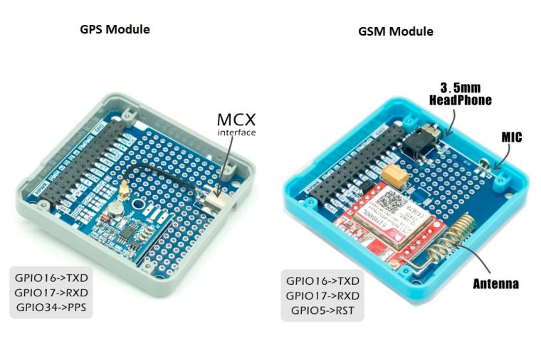

You must bridge the contact areas for connection.<br />
<img src="/assets/uploads/files/1524226967241-1524065523536-m5stack-gsm-and-gps-boards-gpios-used-resized.jpg" alt="0_1524226964012_1524065523536-m5stack-gsm-and-gps-boards-gpios-used.jpg" class=" img-fluid img-markdown" /><br />
The GSM module has not alternatives for connection. It uses GPIO16 and 17 for UART and GPIO5 for reset.<br />
The GPS module has alternative connections. 16&amp;17 or 1&amp;3 or 5&amp;13 for UART. If you d'not need a PPS-signal, you can not bridge it at all.<br />
BUT.<br />
GPIO 1&amp;3 is used USB-UART (CP2104).<br />
I d'not know how to use GPIO 5&amp;13 like a UART. This is not a typical application for ESP32.</p>

]]></description><link>https://community.m5stack.com/post/863</link><guid isPermaLink="true">https://community.m5stack.com/post/863</guid><dc:creator><![CDATA[loboris]]></dc:creator><pubDate>Wed, 18 Apr 2018 22:33:08 GMT</pubDate></item><item><title><![CDATA[Reply to GPS + GSM on Wed, 18 Apr 2018 15:56:49 GMT]]></title><description><![CDATA[<p dir="auto"><a class="plugin-mentions-user plugin-mentions-a" href="/user/richardmike4" aria-label="Profile: richardmike4">@<bdi>richardmike4</bdi></a> Hi Richard,</p>
<p dir="auto">Some modules use the same GPIO - in this case only one module can be actively used at a time.</p>
<p dir="auto">The GPS and SIM modules use the same GPIO - the GPS continually sends data - so at least for the time being it should not be used in the stack at the same time as GSM module.</p>
<p dir="auto"><img src="/assets/uploads/files/1524065523536-m5stack-gsm-and-gps-boards-gpios-used-resized.jpg" alt="0_1524065521512_M5Stack GSM and GPS boards - GPIOs used.jpg" class=" img-fluid img-markdown" /></p>
