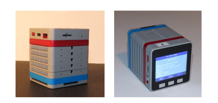

]]></description><link>https://community.m5stack.com/post/872</link><guid isPermaLink="true">https://community.m5stack.com/post/872</guid><dc:creator><![CDATA[daslolo]]></dc:creator><pubDate>Thu, 19 Apr 2018 18:40:05 GMT</pubDate></item><item><title><![CDATA[Reply to how many floors? on Thu, 19 Apr 2018 05:23:25 GMT]]></title><description><![CDATA[<p dir="auto">@jimit 在 <a href="/post/860">how many floors?</a> 中说：</p>
<p dir="auto"><a class="plugin-mentions-user plugin-mentions-a" href="/user/richardmike4" aria-label="Profile: richardmike4">@<bdi>richardmike4</bdi></a></p>
<h3>Behold - the M5Stack Tower !</h3>
<p dir="auto">Note there are some limitations on how the stacks can be used:</p>
<ul>
<li>I would suggest only using one battery module per stack.</li>
<li>Some modules use the same GPIO - in this case only one module can be actively used at a time.</li>
<li>The GPS and SIM modules use the same GPIO - the GPS continually sends data - so here it should not be used in the stack at the same time as GSM module.</li>
</ul>
<p dir="auto"><img src="/assets/uploads/files/1524062627831-mstack-bigstack-resized.jpg" alt="0_1524062626483_MStack-BigStack.jpg" class=" img-fluid img-markdown" /></p>
<p dir="auto">"hack" one of them and move the rx/tx lines to different GPIO's then use serial1 to connect to that module.<br />
Then you have 2 serial's and you can use both modules simultaneously.<br />
When there is will, there is a way :D</p>
<p dir="auto">Hi Richard,</p>
<p dir="auto">I don't think there is a hard limit on the number of "floors" or "stacks" that can be used with the M5Stack.</p>
<p dir="auto">Behold - the M5Stack Tower below !!  Using a total of 9 stacks, including Battery module , Lora module and 5x Proto modules.</p>
<ul>
</ul>
