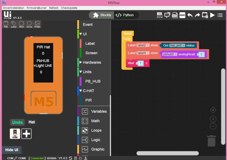

]]></description><link>https://community.m5stack.com/topic/1794/how-to-use-two-env-units-with-pahub-uiflow</link><generator>RSS for Node</generator><lastBuildDate>Tue, 28 Apr 2026 23:57:07 GMT</lastBuildDate><atom:link href="https://community.m5stack.com/topic/1794.rss" rel="self" type="application/rss+xml"/><pubDate>Thu, 26 Mar 2020 05:23:29 GMT</pubDate><ttl>60</ttl><item><title><![CDATA[Reply to How to use two ENV units with PaHUB (UIFlow) on Sat, 18 Apr 2020 14:00:58 GMT]]></title><description><![CDATA[<pre><code>from m5stack import *
from m5ui import *
from uiflow import *
import hat
import unit
import hat
setScreenColor(0x111111)
pbhub0 = unit.get(unit.PBHUB, unit.PORTA)
hat_pir0 = hat.get(hat.PIR)
label0 = M5TextBox(13, 8, "PIR Hat", lcd.FONT_Default,0xFFFFFF, rotate=0)
label1 = M5TextBox(12, 63, "PbHUB", lcd.FONT_Default,0xFFFFFF, rotate=0)
label2 = M5TextBox(34, 34, "0", lcd.FONT_Default,0xFFFFFF, rotate=0)
label3 = M5TextBox(0, 83, "+Light Unit", lcd.FONT_Default,0xFFFFFF, rotate=0)
label4 = M5TextBox(26, 109, "0", lcd.FONT_Default,0xFFFFFF, rotate=0)
while True:
  label2.setText(str(hat_pir0.state))
  label4.setText(str(pbhub0.analogRead(0)))
  wait(1)
  wait_ms(2)
</code></pre>
]]></description><link>https://community.m5stack.com/post/8214</link><guid isPermaLink="true">https://community.m5stack.com/post/8214</guid><dc:creator><![CDATA[liemph]]></dc:creator><pubDate>Sat, 18 Apr 2020 14:00:58 GMT</pubDate></item><item><title><![CDATA[Reply to How to use two ENV units with PaHUB (UIFlow) on Sat, 18 Apr 2020 14:00:08 GMT]]></title><description><![CDATA[<p dir="auto"><img src="/assets/uploads/files/1587218405666-problem-resized.jpg" alt="0_1587218398396_problem.JPG" class=" img-fluid img-markdown" /></p>
]]></description><link>https://community.m5stack.com/post/8213</link><guid isPermaLink="true">https://community.m5stack.com/post/8213</guid><dc:creator><![CDATA[liemph]]></dc:creator><pubDate>Sat, 18 Apr 2020 14:00:08 GMT</pubDate></item><item><title><![CDATA[Reply to How to use two ENV units with PaHUB (UIFlow) on Sat, 18 Apr 2020 13:57:39 GMT]]></title><description><![CDATA[<p dir="auto"><a class="plugin-mentions-user plugin-mentions-a" href="/user/jollawat" aria-label="Profile: jollawat">@<bdi>jollawat</bdi></a> I do not have any ENV Hat, but I have a PIR Hat, and I tried to reconstruct your problem. I connected my PIR Hat and my PbHub (to Port A) of my Stick C. Then I connected my Light Unit to Port0 of my PbHub. Then I programmed using UiFlow to show the measurement results of both the PIR Hat and Light Unit. It worked well. Please see below, the code snapshot and list.</p>
]]></description><link>https://community.m5stack.com/post/8212</link><guid isPermaLink="true">https://community.m5stack.com/post/8212</guid><dc:creator><![CDATA[liemph]]></dc:creator><pubDate>Sat, 18 Apr 2020 13:57:39 GMT</pubDate></item><item><title><![CDATA[Reply to How to use two ENV units with PaHUB (UIFlow) on Sat, 18 Apr 2020 13:54:01 GMT]]></title><description><![CDATA[<p dir="auto"><a class="plugin-mentions-user plugin-mentions-a" href="/user/jollawat" aria-label="Profile: jollawat">@<bdi>jollawat</bdi></a> I did not get it. Please post also your configuration (the connection between Stick-C, Hat and Unit) and your code.</p>
