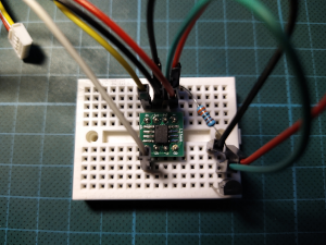

I'm working on using the DS2482 (I2C to onewire) as an interface to the ds18x20.</p>
<p dir="auto"><img src="/assets/uploads/files/1586112369313-980316c7-0ec4-4835-acd6-3dc4a1efe99d-image.png" alt="0_1586112359427_980316c7-0ec4-4835-acd6-3dc4a1efe99d-image.png" class=" img-fluid img-markdown" /></p>
<p dir="auto">There are existing libraries using arduino. I want to use UIFlow/Blockly . Today I just made a commit using UIFlow/Blockly addressing different sensors/devices like the <a href="http://EXT.IO" target="_blank" rel="noopener noreferrer nofollow ugc">EXT.IO</a> unit communicating with an M5Stack master as slaves on the I2C bus.</p>
