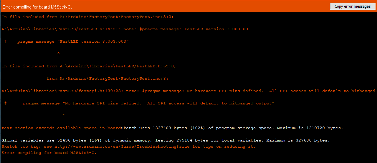

After uploading other examples, I wanted to run FactoryTest again from <a href="https://github.com/m5stack/M5StickC/tree/master/examples/Basics/FactoryTest" target="_blank" rel="noopener noreferrer nofollow ugc">https://github.com/m5stack/M5StickC/tree/master/examples/Basics/FactoryTest</a> but I get an error that it's too large in size. <img src="/assets/uploads/files/1585245257587-error-resized.png" alt="0_1585245228837_error.PNG" class=" img-fluid img-markdown" /></p>
<p dir="auto">Unlike other examples, FactoryTest never displays it's compressing the sketch before an upload.<br />
Please advice.<br />
I'm interested in getting back the cube-gyro test back which is not in other examples.</p>

]]></description><link>https://community.m5stack.com/post/9196</link><guid isPermaLink="true">https://community.m5stack.com/post/9196</guid><dc:creator><![CDATA[gaaahman]]></dc:creator><pubDate>Mon, 29 Jun 2020 23:36:41 GMT</pubDate></item><item><title><![CDATA[Reply to M5StickC - Cannot upload FactoryTest, size too large on Fri, 27 Mar 2020 02:43:02 GMT]]></title><description><![CDATA[<p dir="auto"><a class="plugin-mentions-user plugin-mentions-a" href="/user/gaaahman" aria-label="Profile: gaaahman">@<bdi>gaaahman</bdi></a>  you can change the partition scheme.</p>
<p dir="auto">in the Arduino navigation ----&gt; Tools----&gt;partition scheme------&gt;choose the Not OTA (Large APP)</p>
