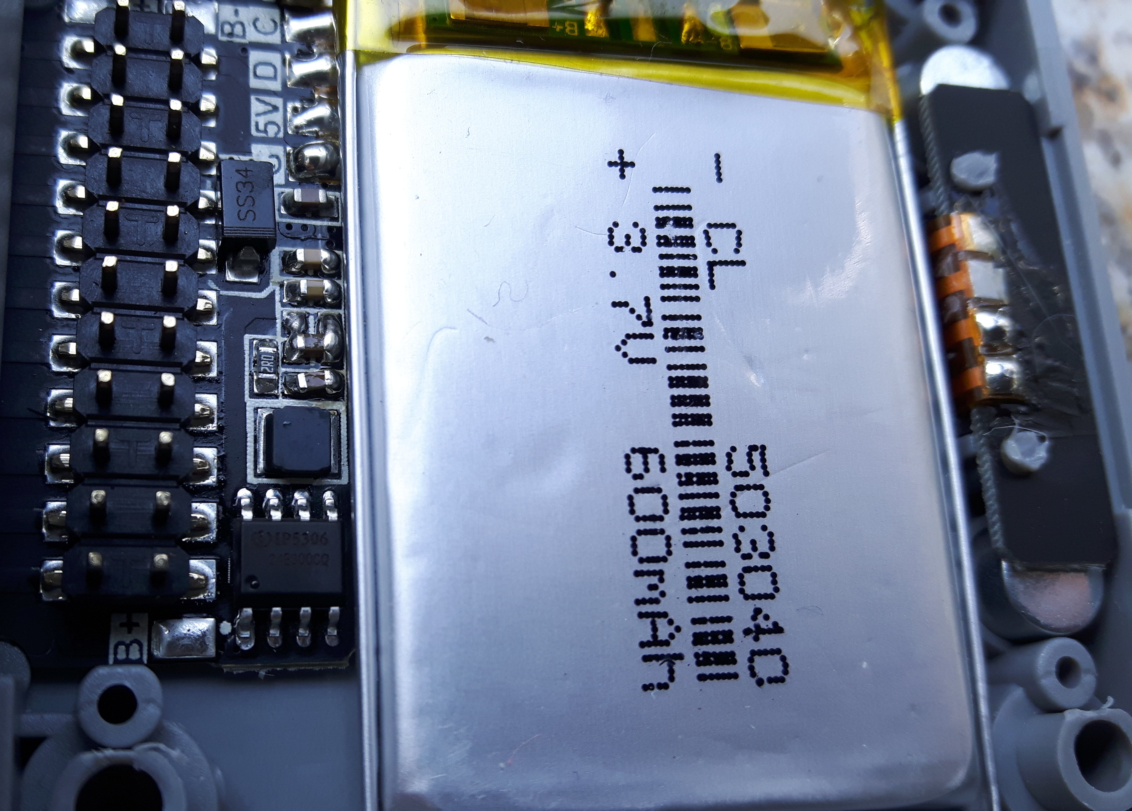

<p dir="auto">I just received my M5Stack with the faces. What I noticed, after I took it apart and reassembled it, the IP5306 was getting hot and even after shutting it off, it staid hot. I also noticed there may be a capacitor missing, not sure, looks odd, hand soldered,... .</p>
<p dir="auto"><img src="/assets/uploads/files/1524308908991-m5stack_ip5306_bodge-resized.jpg" alt="0_1524308883204_M5Stack_IP5306_Bodge.jpg" class=" img-fluid img-markdown" /></p>
<p dir="auto">I disconnected the battery and took a photo. Can anyone tell me how to solve the problem, maybe where I can find that schematics and if a cap is missing, or latch-up is a problem with the IP5306? Did something latched up is you stack the modules without disconnecting the battery?</p>

<p dir="auto">I found some pictures on the web, the pads are not populated and yes it is a short!! I removed the short with some fluxed solderwick and hope nothing is damaged by the short.</p>
<p dir="auto">Hopefully the M5Stack-team respondes on how that could happen in production and releases the schematics and placement of parts.</p>

Hi Seppel,</p>
<p dir="auto">Is there a solder bridge between G and 5V ?  Is this what you are referring to ? Looks like there may be but i can't be sure from the pic.</p>
<p dir="auto">Did you do a buzz test (continuity test ) with a multimeter ? Defintely worth doing to confirm whether it is actually active and is a real problem.</p>
<p dir="auto">There definitely should not be a solder bridge there between G and 5V. A bit of careful re-soldering of that joint should do the trick - if indeed it is an active solder bridge.</p>
<p dir="auto">As far as I'm aware schematics have not been released for the FACES model.</p>
<p dir="auto">You speculated about a missing cap, but I don't know what location on the board you were referring to. Perhaps some directions? I doubt they just missed adding a cap.</p>
]]></description><link>https://community.m5stack.com/post/881</link><guid isPermaLink="true">https://community.m5stack.com/post/881</guid><dc:creator><![CDATA[JJ]]></dc:creator><pubDate>Sat, 21 Apr 2018 17:37:55 GMT</pubDate></item><item><title><![CDATA[Reply to IP5306 getting hot, latchup? Bodge-Job on th PCB! on Sat, 21 Apr 2018 15:36:52 GMT]]></title><description><![CDATA[<p dir="auto">I removed the battery, the pad's are shorted out, can anyone tell me if that is normal? Maybe someone can send me a picture of his unit? I guess I got a bad one, so how can I fix it, is there a schematic?</p>
<p dir="auto"><img src="/assets/uploads/files/1524324834203-m5stack_ip5306_bodge_closeup-resized.jpg" alt="0_1524324810606_M5Stack_IP5306_Bodge_closeup.jpg" class=" img-fluid img-markdown" /></p>
<p dir="auto">Thank you very much.</p>
