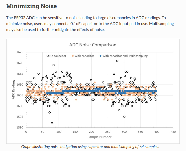

<p dir="auto">I just programmed another ESP32 (Heltec LoRa) with micropython reading analog values from GPIO 34 and observed quite a noise (and drift). Apparently the noise is typical for the ESP32 family microcontrollers due to crosstalk from other components on the chip such as Wifi, Bluetooth, clocks.  In their spec Espressif talks about a mean noise of +/- 7 digits on the GPIO ADC channel 1 (GPIO 32-39). In order to improve your readings  you should consider two improvements:</p>
<ol>
<li>Your 60k potentiometer is quite big. Normally a 10K is used (as in the M5Stack angle unit).</li>
<li>As described in the Espressif API reference<br />
<a href="https://docs.espressif.com/projects/esp-idf/en/latest/esp32/api-reference/peripherals/adc.html#minimizing-noise" target="_blank" rel="noopener noreferrer nofollow ugc">https://docs.espressif.com/projects/esp-idf/en/latest/esp32/api-reference/peripherals/adc.html#minimizing-noise</a><br />
you can minimize noise for your ADC readings by adding a capacitor between the ADC GPIO input line and GND as well as taking the avarage of multiple readings (multisampling) . Here is the graph of the Espressif document showing the improvement of the ADC readings:</li>
</ol>
<p dir="auto"><img src="/assets/uploads/files/1586546765770-8d3c4af6-54df-4d6d-a969-e6f53a8b5dc1-image.png" alt="0_1586546765034_8d3c4af6-54df-4d6d-a969-e6f53a8b5dc1-image.png" class=" img-fluid img-markdown" /></p>
<p dir="auto">ADC channel 2 (GPIO 0,2,4,12-14,25-27), is supposed to be noisier, because it's also used by the WiFi component. The M5Stack speaker is attached to GPIO Pin 25 (ADC Channel 2).</p>
