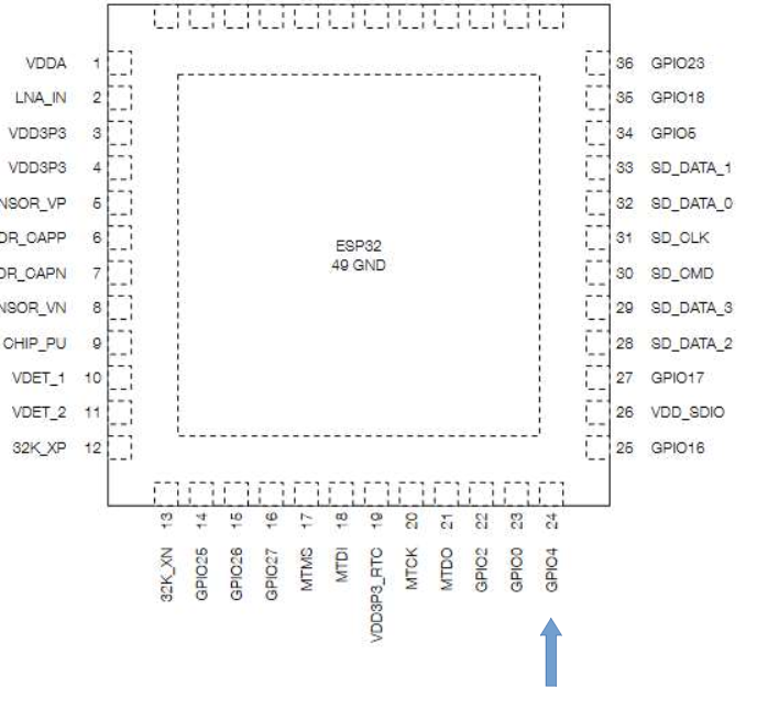

<p dir="auto">Using GPIO4 CS ?  It is used as CS on the micro SD card reader of the M5Stack: You either have to solder a wire to your ESP32:</p>
<p dir="auto"><img src="/assets/uploads/files/1586717164809-9ef98010-a52f-4a4e-9e6a-79b669499a82-image.png" alt="0_1586717155260_9ef98010-a52f-4a4e-9e6a-79b669499a82-image.png" class=" img-fluid img-markdown" /></p>
<p dir="auto">or make a micro sd card adapter connecting wires to micro sd card:<img src="/assets/uploads/files/1586716835293-75d899e5-34fd-4672-9285-01744d8e4c14-image.png" alt="0_1586716832850_75d899e5-34fd-4672-9285-01744d8e4c14-image.png" class=" img-fluid img-markdown" /><br />

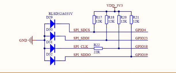

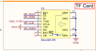

GPIO4 is on your microSD Pin 2 !<br />
You can get all the SPI signals you wanted in the sd Micro card adapter ! <a href="https://github.com/m5stack/M5-Schematic/blob/master/Core/Basic/M5-Core-Schematic(20171206).pdf" target="_blank" rel="noopener noreferrer nofollow ugc">https://github.com/m5stack/M5-Schematic/blob/master/Core/Basic/M5-Core-Schematic(20171206).pdf</a><br />
<img src="/assets/uploads/files/1586717906304-fba69185-f178-408f-918d-707836984713-image.png" alt="0_1586717905380_fba69185-f178-408f-918d-707836984713-image.png" class=" img-fluid img-markdown" /></p>
