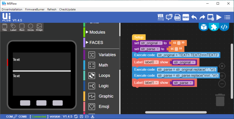

wiht the Execute code of the advanced section you can enter python code, because if you take the replace block in the text section the '\n' will be changed by UIFlow into '\n'.<br />
See my UIFlow-Example:<br />
<img src="/assets/uploads/files/1587492003841-parse_string-resized.png" alt="0_1587491992793_parse_string.png" class=" img-fluid img-markdown" /></p>

<p dir="auto">str_original = ''<br />
str_parse = ''<br />
str_original = 'TEXT1 TEXT2\n\nTEXT3'<br />
label0.setText(str(str_original))<br />
str_parse = str_original.replace(' ', '\n')<br />
str_parse = str_parse.replace('\n\n', '\n')<br />
label1.setText(str(str_parse))</p>
