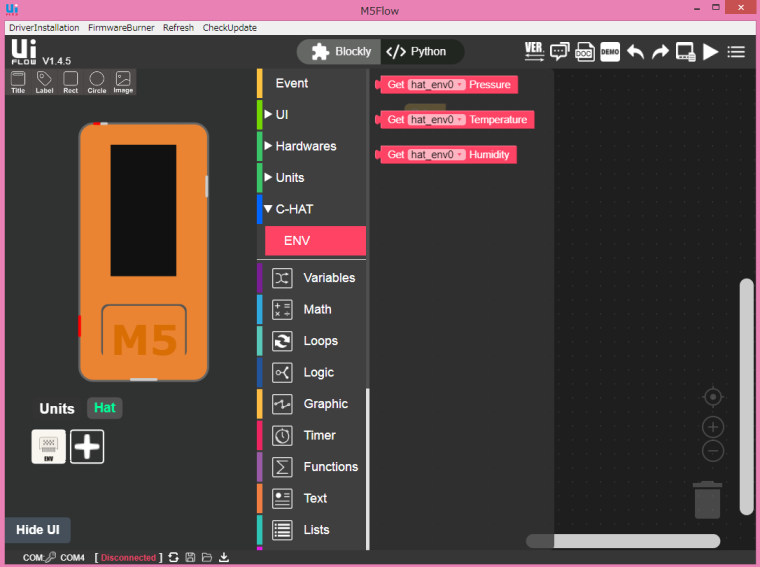

]]></description><link>https://community.m5stack.com/post/8349</link><guid isPermaLink="true">https://community.m5stack.com/post/8349</guid><dc:creator><![CDATA[ajb2k3]]></dc:creator><pubDate>Sat, 25 Apr 2020 07:30:59 GMT</pubDate></item><item><title><![CDATA[Reply to Env Hat Compass on Fri, 24 Apr 2020 23:48:10 GMT]]></title><description><![CDATA[<p dir="auto"><a class="plugin-mentions-user plugin-mentions-a" href="/user/xis" aria-label="Profile: xis">@<bdi>xis</bdi></a> <img src="/assets/uploads/files/1587772085748-30b6df07-e618-4583-83be-baf69b455dfa-image-resized.png" alt="0_1587772080865_30b6df07-e618-4583-83be-baf69b455dfa-image.png" class=" img-fluid img-markdown" /></p>
]]></description><link>https://community.m5stack.com/post/8345</link><guid isPermaLink="true">https://community.m5stack.com/post/8345</guid><dc:creator><![CDATA[liemph]]></dc:creator><pubDate>Fri, 24 Apr 2020 23:48:10 GMT</pubDate></item><item><title><![CDATA[Reply to Env Hat Compass on Fri, 24 Apr 2020 23:47:49 GMT]]></title><description><![CDATA[<p dir="auto"><a class="plugin-mentions-user plugin-mentions-a" href="/user/xis" aria-label="Profile: xis">@<bdi>xis</bdi></a> said in <a href="/post/8343">Env Hat Compass</a>:</p>
<p dir="auto"><a class="plugin-mentions-user plugin-mentions-a" href="/user/liemph" aria-label="Profile: liemph">@<bdi>liemph</bdi></a> here <a href="https://docs.m5stack.com/#/en/hat/hat-env" target="_blank" rel="noopener noreferrer nofollow ugc">https://docs.m5stack.com/#/en/hat/hat-env</a> says one of the applications is Compass</p>
<p dir="auto">You are correct. If you could get the value from the magnetometer (at least x and y) then there is a possibility to make a compass application. I work with UiFlow 1.4.5 and I could not find it from the standard way (for the time being, using this version). A newer version may provide the capability or you may try to build your own block (python) for reading the values (sorry I can not guide you further for this since I am now still learning how to include my own python program into the UiFlow).</p>
]]></description><link>https://community.m5stack.com/post/8344</link><guid isPermaLink="true">https://community.m5stack.com/post/8344</guid><dc:creator><![CDATA[liemph]]></dc:creator><pubDate>Fri, 24 Apr 2020 23:47:49 GMT</pubDate></item><item><title><![CDATA[Reply to Env Hat Compass on Fri, 24 Apr 2020 22:44:07 GMT]]></title><description><![CDATA[<p dir="auto"><a class="plugin-mentions-user plugin-mentions-a" href="/user/liemph" aria-label="Profile: liemph">@<bdi>liemph</bdi></a> here <a href="https://docs.m5stack.com/#/en/hat/hat-env" target="_blank" rel="noopener noreferrer nofollow ugc">https://docs.m5stack.com/#/en/hat/hat-env</a> says one of the applications is Compass</p>
