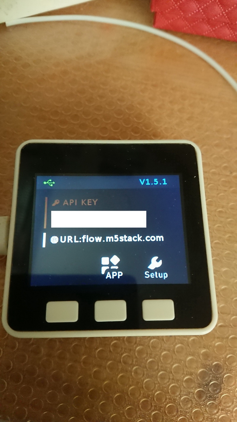

Now to my problem, set the M5Stack in the setup to SwitchMode USB-Mode, reboot executed, then I get the following message (see picture)!<br />
<img src="/assets/uploads/files/1587790091937-dsc_0002-resized.jpg" alt="0_1587790071484_DSC_0002.JPG" class=" img-fluid img-markdown" /></p>
<p dir="auto">For me it now looks like the connection is established, see USB symbol in the upper left corner.<br />

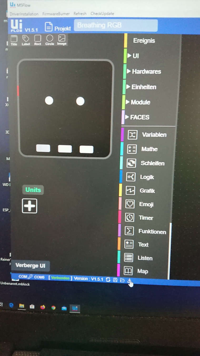

But if I try to establish a connection with the software, the M5Stack restarts itself. After 2-3 connection attempts the connection is established according to UIFlow Desktop 1.5.1 version (see picture)</p>
<p dir="auto"><img src="/assets/uploads/files/1587790353955-dsc_0001-resized.jpg" alt="0_1587790327954_DSC_0001.JPG" class=" img-fluid img-markdown" /></p>
<p dir="auto">But even after a successful connection has been established, it is still the case that if I want to install a program that as soon as I press the button below (see picture above mouse pointer) the M5Stack immediately restarts.<br />

]]></description><link>https://community.m5stack.com/topic/1890/problems-when-installing-programs-in-usb-mode-software-uiflow-1-5-1</link><generator>RSS for Node</generator><lastBuildDate>Wed, 29 Apr 2026 22:37:08 GMT</lastBuildDate><atom:link href="https://community.m5stack.com/topic/1890.rss" rel="self" type="application/rss+xml"/><pubDate>Sat, 25 Apr 2020 04:54:40 GMT</pubDate><ttl>60</ttl><item><title><![CDATA[Reply to Problems when installing programs in USB mode Software UIFlow 1.5.1 on Thu, 07 May 2020 16:16:37 GMT]]></title><description><![CDATA[<p dir="auto">@ m5stack</p>
<p dir="auto">I have installed the update. Now it works great!!</p>
<p dir="auto">With version 1.4.5 and 1.5.1 !</p>
<p dir="auto">Thank you very much for the fast problem solution!!</p>
<p dir="auto">Top !!</p>
<p dir="auto">greeting skink</p>
]]></description><link>https://community.m5stack.com/post/8551</link><guid isPermaLink="true">https://community.m5stack.com/post/8551</guid><dc:creator><![CDATA[Skink]]></dc:creator><pubDate>Thu, 07 May 2020 16:16:37 GMT</pubDate></item><item><title><![CDATA[Reply to Problems when installing programs in USB mode Software UIFlow 1.5.1 on Thu, 07 May 2020 10:40:01 GMT]]></title><description><![CDATA[<p dir="auto"><a class="plugin-mentions-user plugin-mentions-a" href="/user/m5stickfreakler" aria-label="Profile: m5stickfreakler">@<bdi>m5stickfreakler</bdi></a> pls click IDE navigation “checkupdate” btn, upgarde the IDE version. will be fix this problem</p>
]]></description><link>https://community.m5stack.com/post/8544</link><guid isPermaLink="true">https://community.m5stack.com/post/8544</guid><dc:creator><![CDATA[m5stack]]></dc:creator><pubDate>Thu, 07 May 2020 10:40:01 GMT</pubDate></item><item><title><![CDATA[Reply to Problems when installing programs in USB mode Software UIFlow 1.5.1 on Fri, 01 May 2020 15:56:22 GMT]]></title><description><![CDATA[<p dir="auto"><a class="plugin-mentions-user plugin-mentions-a" href="/user/m5stack" aria-label="Profile: m5stack">@<bdi>m5stack</bdi></a> Please make UIFlow-Desktop working with usb mode and firmware 1.5.x</p>
