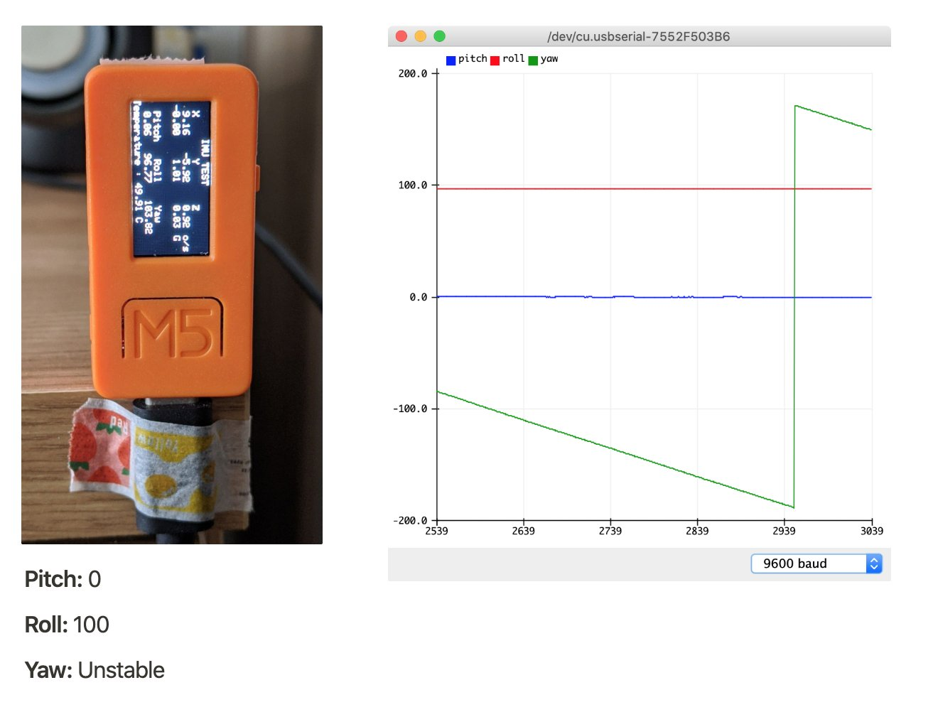

<?xml version="1.0" encoding="UTF-8"?><rss xmlns:dc="http://purl.org/dc/elements/1.1/" xmlns:content="http://purl.org/rss/1.0/modules/content/" xmlns:atom="http://www.w3.org/2005/Atom" version="2.0"><channel><title><![CDATA[M5Stick IMU Yaw Readings Off]]></title><description><![CDATA[<p dir="auto">I did some calibration with my M5stick to see what the IMU pitch, yaw, and roll readings would be based on the example IMU Arduino app included with the M5stick library.</p>
<p dir="auto">It seems like the Yaw values seem to always be drifting – is this a known issue, or is there a way to account for it?</p>
<p dir="auto"><img src="/assets/uploads/files/1588322720034-b1d8c220-d79d-4e36-9222-b8b9cf16d1b0-image-resized.png" alt="0_1588322717909_b1d8c220-d79d-4e36-9222-b8b9cf16d1b0-image.png" class=" img-fluid img-markdown" /></p>

]]></description><link>https://community.m5stack.com/post/8479</link><guid isPermaLink="true">https://community.m5stack.com/post/8479</guid><dc:creator><![CDATA[scientiffic]]></dc:creator><pubDate>Sat, 02 May 2020 08:00:34 GMT</pubDate></item><item><title><![CDATA[Reply to M5Stick IMU Yaw Readings Off on Fri, 01 May 2020 18:34:33 GMT]]></title><description><![CDATA[<p dir="auto"><a class="plugin-mentions-user plugin-mentions-a" href="/user/scientiffic" aria-label="Profile: scientiffic">@<bdi>scientiffic</bdi></a> Without magnetometer yaw value will always drift.</p>
<p dir="auto">Yaw value cannot be determined from accelerometer readings. Yaw value is integrated gyroscope readings which are rate of change. Integration is never perfect and this will cause yaw to slowly drift.</p>
